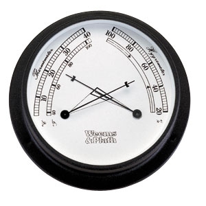

Posted 2005-08-09 7:53 AM (#141094 - in reply to #141090)
Subject: Re: humidifier question
Posts: 1673
One of these is on my "to order list".
The intersecting needles of the thermometer and hygrometer provide a visual indication to help you maintain humidity nirvana for your guitars.
It provides a no-brainer indication when other measures are required to protect your wood.
