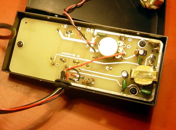

Joined: December 2003 Posts: 1071 Location: Carle Place, NY | Back in the mid 80's the Balladeers had the FET3 while the Legends had the OP24. Both look the same, 3 band eq with volume. Does anyone know what the differences are between the two? | ||

Joined: January 2002 Posts: 14127 Location: 6 String Ranch | OP had op amps that powered it and the FET had fet amps (field effect transistors, whatever they were) I recall the op24 having more dynamics. It basically is the same as the Magnum 2 electronics. I still like the sound of the OP24 but I'm just an old retired gas station fart living on a fixed income so wtf do I know? | ||

Joined: August 2004 Posts: 709 Location: Germany | The pics provide an insight in the preamp boxes. The upper one shows the FET3 with one field effect transistor. The lower pic shows the OP24 with his 6 operational amplifiers (the black bugs) each providing 24 transistors. From technical point of view the OP24 is the more advanced preamp. I agree to Bill, it has more dynamics - it sounds better! Karl | ||

Joined: August 2004 Posts: 604 Location: Tampa, FL | BHB, "Op amp" is an abbreviation for the term operational amplifier. In somewhat watered down terms, it refers to an electronic circuit that can be modeled as a chunk of gain with 'differential' inputs (quoted because, while they appear to be inversely related, they are missing much of the common mode rejection of a true Diff amp). You see them a lot because they are so convenient to design with and many are jelly bean cheap. I'm a little surprised to see them in an instrument preamp. In the 80's the rule of thumb was for low frequencies (DC - 1kHz) op amps were ok, but once you got into the upper midrange audio freqs, you had to go discrete for fidelity reasons. When I was last doing instrumentation design, mid nineties, there were a number of companies out there, Linear Technologies was my favorite, that were doing some pretty incredible things with linear IC's. LT had an engineer working for them, Jim Williams, that had a wonderfully twisted appreciation of electrical engineering. IMHO his best design was a light emitting pickle. To return to topic, I think Jeff has a higher percentage chance of being right about the OP prefix. Although, the morphing of the FET preamp into an op-amp design lends credence to BHB suggestion. I guess you'd have to ask those model naming masters from marketing to get the definitive answer. | ||

Joined: August 2004 Posts: 709 Location: Germany | The 1987 Ovation catalog says that each of the six operational amplifier of the OP24 has 24 transistors. So I think OP24 stands for "OPerational Amplifiers with 24 transistors each". But who knows? Karl | ||
