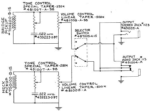

I was hoping someone could help me out here . I am fixing a preacher for my friend (very cool guitar btw). The toggle for the pickup select went bad. Normally just look at wires and attach same way.Not this time, Switch is off guitar completely and not sure if switch in case is the one that is correct. do i need a special toggle or will a 3 way on/on/on work fine? There are 4 wires to connect. 2 yellows and 2 reds.Im sure there is a jumper in there somewhere too.
Any help would be greatly appreciated.Thanks in advance.

It is a 3 way on/on/on.
Here's a schematic:
http://www.ovationfanclub.com/photos/BruDeV_67009_preacher%20wiring...
If you need a picture, I can post one on Monday or Tuesday.

I picked up the switch today.Thanks for the schematic Brudev, but i am kinda schematic illiterate.Shoulda payed attn in class. :) I dont think i need a pic posted. maby if you could just tell me what goes where.
here is the prongs numbered on the bottom of switch,
1 -2- 3
__ __ __
__ __ __
4 -5- 6
I have 4 wires,1 red coming from volume pot 1 (closest to neck),1 red coming from an output jack,1 yellow coming from other volume pot, and 1 yellow coming from output jack. and im sure there has to be a jumper in there somewhere.
i was thinking pickups to 4 and 6 and outputs to 1 and 3. then what about middle position?
Thanks again in advance for the help.

one red to 1 the other to 2.
one yellow to 5 the other to 6.
Or depending on the switch.
one red to 2 the other to 3.
one yellow to 4 the other to 5.
Sorry about the delay, I've been without phone lines since Saturday.
