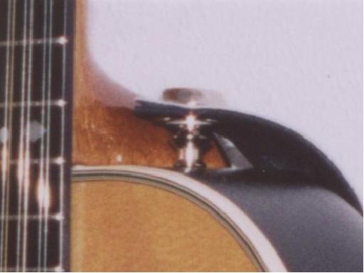

I want to install Dunlop buttons on this guitar, and I want to change the location of the upper button from the shoulder on the treble side to the bass side. As I observe the construction of the neck-to-body joint, I notice this isn't a bolt-on neck (no bolts inside). Is this a mortice & tennon joint? and I also don't see the other side of the screw that holds the strap button on. I assume that the screw simply goes into the block of wood. So that must mean I can simply remove the existing button and screw the new one in on the other side...the same distance away from the neck so as not to miss the block. Do the experts concur, or must we confer? John <>{

First, you can install the Dunlop Straplocs (my choice!) using the exiting screw and hole. Put the screw in a drill and file down the outer diameter. This allows a seamless upgrade.
If you must move the button you will notice that the screw goes into something like a drywall receiver. This must be moved to the new location.
If I missed this model and what you have is a wood screw that does go into the heel block you can remove it and use the Dunlop screw in the new location although it may need something to back it up. Once the Fiberglass hole is loosened it will only grow and oblongate.
I vote for new button in the original location with the old screw (machine) if possible.

This is what I had. Is your's different?

The screw does go into a block of wood at the neck joint on the older O's. Look inside and you'll see it. Drill a small pilot hole on the bass side of the neck and switch the location. You'll be left with the old hole still visible, but from the way you've described this guitar that extra cosmetic defect won't matter.

After looking at that pic, I think I'm gonna put the new one in the same place as the old one. The guitar really does look good. Only cosmetic issue is the crack at the seam, but it has been repaired nicely. I don't need an old screwhole to try and hide. Thanks for the feedback everyone. I'm begining to think I'm gonna have a pretty nice guitar when I'm through. John <>{

You need a molly bolt. Or make a small block of wood and hold it on the inside and let the screw go into that.
