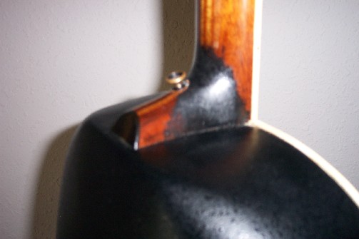

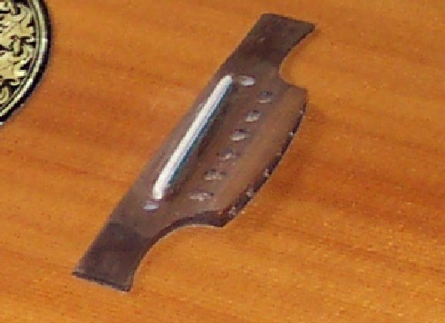

Alright, here we go. I put several pics in an album. On closer inspection, there are two plastic pins which go thru the soundboard. This doesnt look like the same person who hacked the rest of this guitar. Also, the soundboard is dead flat and it doesnt look like the bridge has ever been removed. These pins are made of the same material as the nut. Looks like milk carton plastic.

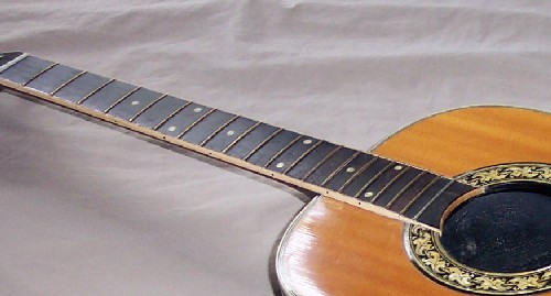

Anyway, Anybody seen an inlay pattern like this?
Posted 2005-09-28 9:36 PM (#135619 - in reply to #135608)
Subject: Re: '68-'70 Legend ?
Posts: 15682
Somebody's played with that guitar. Those aren't Ovation style fretmarkers. Looks like somebody put a whole new fretboard on the guitar. This is interesting.

Posted 2005-09-29 9:09 AM (#135621 - in reply to #135608)
Looks like an O neck and headstock. The fretboard definitely looks wrong.
I wonder if putting the strap pin in the middle of the heel had anything to do with the neck breaking.
Posted 2005-09-29 9:11 AM (#135622 - in reply to #135608)
. . . or it's there t'help hold the break together . . .
Posted 2005-09-29 9:23 AM (#135623 - in reply to #135608)
...or that's what really holding the neck on now...

Yep... what you cant see is the spike thru the neck heel. I think the strap button was placed there to try and hide the nail head. I for sure have my eye out for a neck.
That fretboard is a mystery because that's the original binding. Why would anyone do that? Anyway, this odd guitar sounds like a real "tweener", and thats why I thot it might be the original fretboard. Told it is trimmed like a DB, with the numbers of a legend. A winged bridge and textured bowl. What a mutt.
