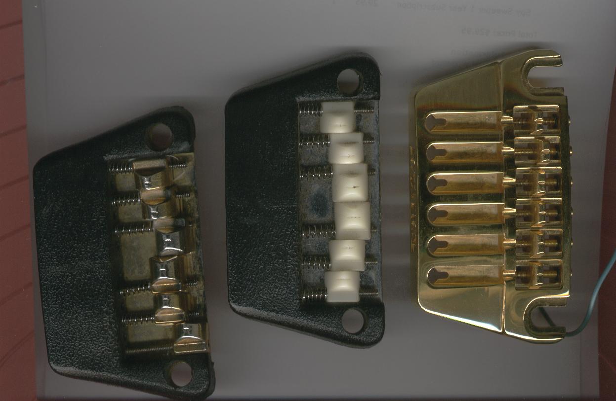

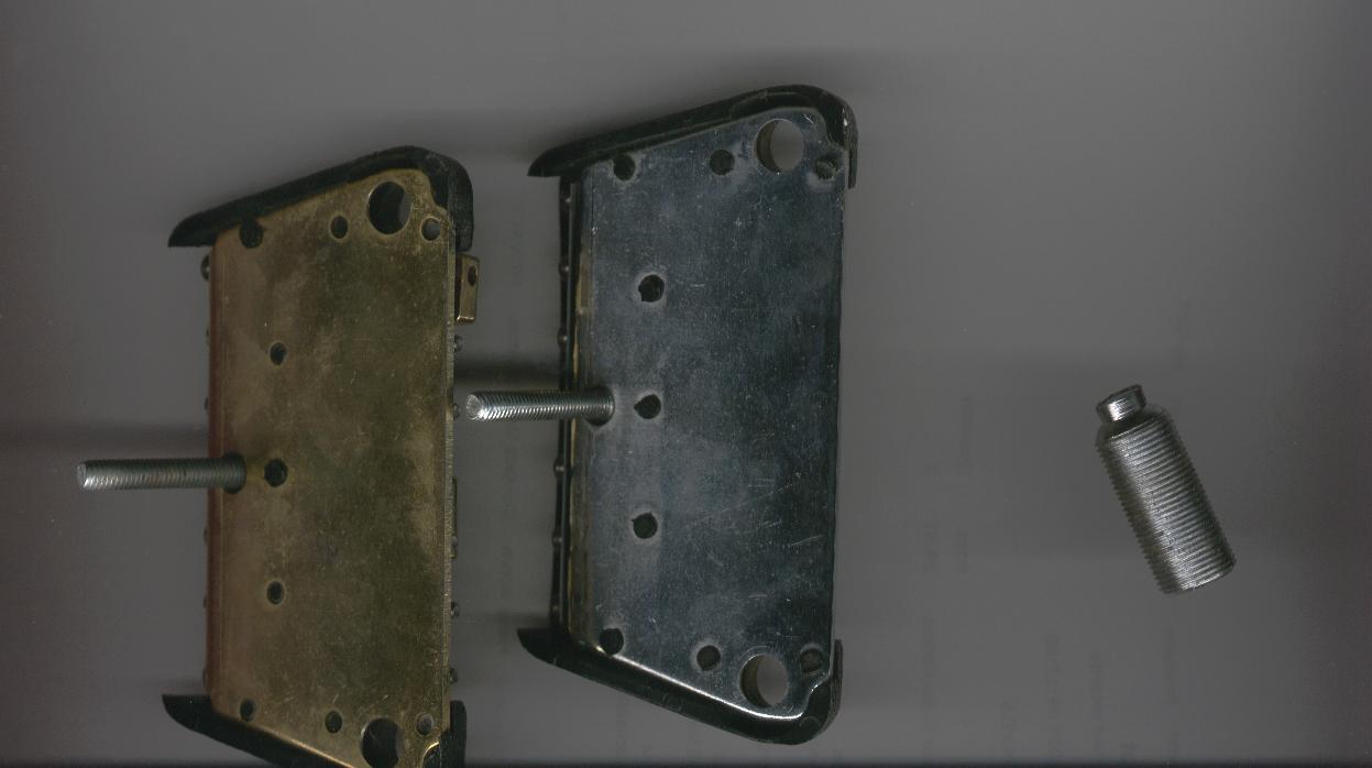

Bridge backsides Bridge frontside
So your posts are still good but you blew out the bridge holes (at 5/16" diameter)!
Did you have the nylon or brass bridge? Do these look familiar?
Edit - you stripped the receiver sockets that are part of the body?
This is the worst thing. I am thinking Helicoil. Actually, sending it back to the factory is best!

MWoody, it's the nylon-saddle bridge, the one in the middle on your photos. I took another look at it and to tell you the truth I'm not even sure how the screws stayed attached in the first place -- I'm wondering if something like Tone Pro locking studs might solve the problem.

Posted 2005-11-28 8:23 PM (#128251 - in reply to #128244)
Subject: Re: Breadwinner bridge replacements
Work with me here, my light isn't on yet.
The two "screws" you refer to - are they the 1/2" diameter threaded posts?
If so, they do not attach to the bridge, the bridge rests on them.
With the string pressure pulling the bridge on to the posts and the middle 1/4" anchor post attached these posts adjust the height of the bridge.
Are the holes on your bridge where the posts ride - ripped through?
jos
Posted 2005-12-03 10:17 PM (#128252 - in reply to #128244)
Posts: 4
After I saw this last post, I restrung the guitar and you're right, the bridge does rest on those posts. I thought somehow it attached to the guitar via the posts (but couldn't figure out how), and thought I'd broken it.
Ah, this is such good news. Thanks for talking me off the ledge.
