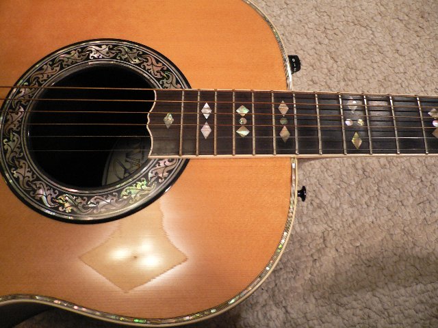

JohnKline
Posted 2007-02-06 11:13 AM (#123981 - in reply to #123967)
Subject: Re: signs of a dried out top on a custom legend?
Posts: 8
Here's the picture of my 1975 Ovation Custom Legend, the rubber grip is pulling away just a bit. The top is still somewhat sunken but it doesn't affect playability and no cracks!

Location: CT
That's really nice. I like the Patriot style TRC. I know the old ones didn't have the abalone sound hole ring, but does this also not have the abalone body binding?, or is it just not showing up in the photo?
Posted 2007-02-07 2:27 PM (#123985 - in reply to #123967)
That full on view looks very nice.
