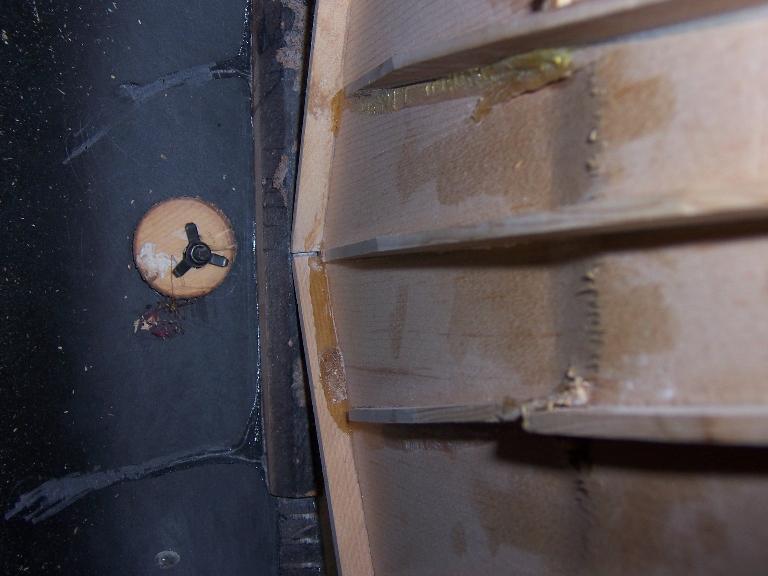

Here's the belly bust:
And from the inside:
More pics in the Photo Gallery under me and AE33

tommy, is that a crack in the underside of the soundboard where that broken brace is?? jason

The gray area it is a 'divot' with some surface spliters showing. The wood grain did not show up very well in this pic. It is not cracked clean through.
The broken brace was, I'm speculating here, caused by the fact that the top and the brace jig were out of register when the braces were positioned and glued. Then when they drilled the hole for the p'up wire the drill came down through the middle of the brace. I assume that when steel strings were installed the brace snapped in two.
