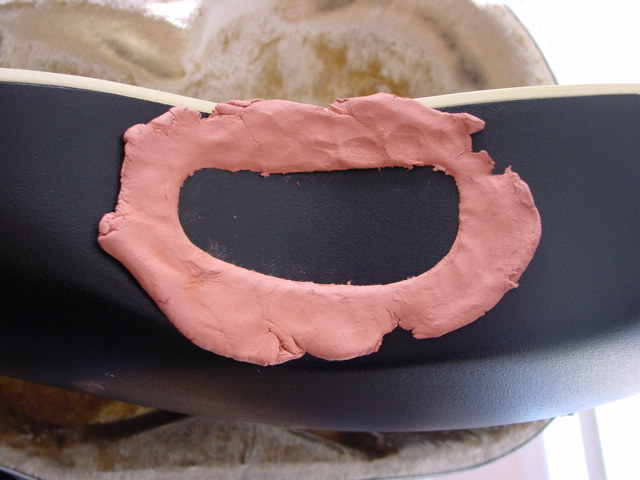

Joined: August 2006 Posts: 3145 Location: Marlton, NJ | BHB - I just did that with a custom Balladeer. I used modeling clay to make a mold off of a 2005 collectors. As soon as it hardened, I just moved it around on the CB until I found the exact spot where it fit. If you need it, I can ship it to you (the mold that is). | ||

Joined: August 2006 Posts: 3145 Location: Marlton, NJ | Wabbit - I used the '05 as a guide - which is a contour bowl - and traced it onto a Custom Balladeer, which is a deep bowl. The match was pretty close to 100%. Here are the pics: The first pic shows the mold being made on the '05 and the second one shows the finished mold against the balladeer. Basically you find the spot on the guitar you want to make the hole in and trace around the inside of the mold. Like I said, I can send you mold if you like. I don't think I'll be doing this again for awhile. Wabbit - I did try the reverse mold first, but there wasn't really enough surface area to work with. I also tried one of those tools that they use to trace the shape of moldings but that was only 2 dimensional. | ||

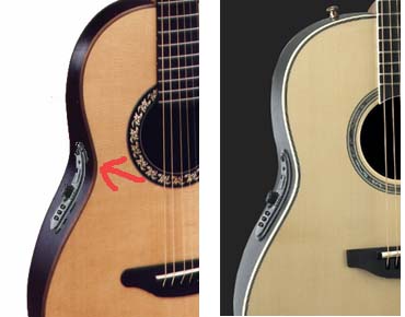

Joined: February 2005 Posts: 11840 Location: closely held secret | That looks good, but the only difference between the '05 and the Balladeer bowls (AFAIK) is the bowl depth and the back contours. The potential difference I was talking about is the actual body shape, the curve of the lower bout coming out of the waist. The '97 appears to have a narrower lower bout than a standard bowl (of any depth). This could make the angle that the lower bout comes out of the waist shallower than a normal bowl. As the preamp fits into that curve, it may not match the angle on the '97. '97 on the left with photoshopped preamp... Or I could be wrong. I'm sure someone will let me know. Form a line, form a line!!! | ||

Joined: February 2005 Posts: 11840 Location: closely held secret | Of course, at the worst one of two things... either you'll have a gap in the middle, or at the ends. If it's at the ends, don't snug the can down to correct it or you may crack the bowl. | ||
