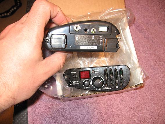

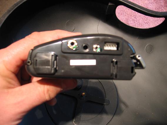

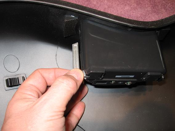

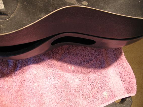

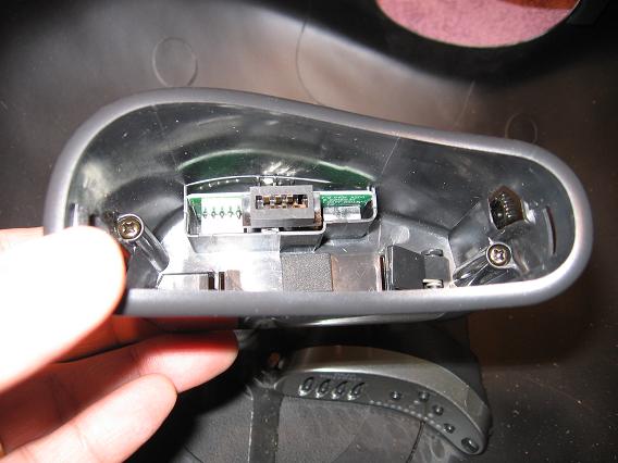

OK, Listen up! Class is in session. Due to availability of instructional items and the fact I'm at home waiting for a day of Medical appointments let's do a little 3D BB on the Preamp change out.
The "can" is the same but the connecting hardware to the preamp is specific for most preamps. Here is an OP30 and an OP Pro Studio.
The OP Pro and OP Pro Studio use the same can by the way.
In the last picture you have a side by side of the modern bowl and a Kaman Bar glass bowl. The glass bowl isn't a precise fit for the kidney shaped preamp can.
Changing Preamps is a snap when the Top is missing! If you change the kidney shaped units out you most likely need a new can as well as matching the 1/4" and XLR outputs.

Interesting! What holds the cans in place?
Posted 2007-04-24 12:36 PM (#103919 - in reply to #103913)
Subject: Re: Another VIP PreAmp Question
There are small wedges on the side of the bowl and two pop-out units on the side of the can that tighten with screws from the inside.
