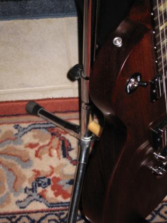

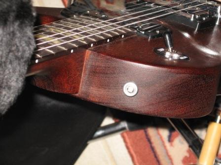

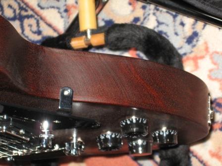

I'm clueless with woodworking. I need some help with a Nitro finish. This is one of the newer Les Paul vintage mahogany finishes. Satin, fairly rough surface, it's called 'worn brown'
Is there anything I can do easily at home to deal with the milky finish on the sides of the guitar? Something to help bring out the natural grain of the wood. The milky look is driving me crazy.

Never worked with nitro.
Did you try cleaning with naptha first?
If it's something on the surface, you can try buffing with meguire x. Pick the spot where it'll get ruined anyway, the buckle rash spot. This will definitely give you a shinier finish.
The problem you have is if the milkiness is a deep fundamental part of the finish. If so, I'm not sure, but I think the only thing you can do is strip it, and finish it yourself, either with nitro, one of MWoody tung oils, maybe try tru-oil or something else.

Nitro finishes are some of the easiest to work with. I would first try cleaning with denatured alcohol to make sure it's not just residue from a waxy guitar polish. Stewmac sells matte clear nitro lacquer in aerosol cans. You should be able to fine sand the milky edges (which were intentionally left really rough on the "worn" finishes), and apply some new new lacquer. I would think a couple of light coats that dried right, would be clear, not milky.

It came from the factory this way. If you read the reviews on harmony central, the quality of the finish varies widely. I love the way it plays, the finish is great everywhere except the sides all the way around.
I tried a very soft touch of 0000 steel wool with a little murphy's oil soap as a lube. it didn't do anything. I tried putting some oil on it, no luck. I tried clear paste waxes from Butchers, Johnson and Trewax. All it did was make it smell like wax and turpentine.
I saw something at the hardware store called Howard's restore a finish, it's just a wipe on wipe off type of deal, but it has some color to it. Too scared to buy it though...
Not sure if this helps, but i took off the covers on the back of the guitar and the wood is very light colored, so the brown is a stain.

looks like it might be an end-grain issue where the gain has run-out on the guitar sides... as if it wasn't sealed properly before final finish coats. End gain can be tricky...
If so... To remedy, you would need to get down to the wood- seal and then finish.

I tried the Howard's Restor-a-finish in the mahogany color, and it worked great.
you can still see the run out, but the milk is gone..This was 2 hours after application.
