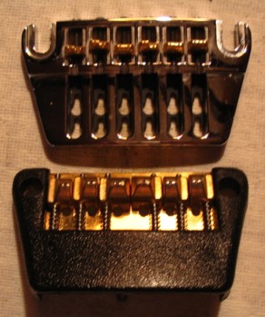

if it has the old style brass and plastic bridge it mounts and adjusts at 3 points hence the screw in the back,
if it has the newer chrome or gold schaller bridge it only mounts at 2 points and the screw is unnecessary... just filling a hole.

That's right. The later ones had that hole filled so you have a "transition" model.

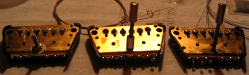

Which type of bridge do you have?
Type 1 or 2?
BruDeV
Posted 2007-06-11 11:07 PM (#92621 - in reply to #92614)
Subject: Re: sorry, i got more questions about my UKII......
January 2003
Posts: 1498
If type 2: it sounds like you are missing the rear nut.
1)Breadwinner/Deacon/Deacon 12
2)UK II with spacer
3)UK II without spacer

from http://www.ovationtribute.com
helped me a lot understanding the construction.
@BruDev
at the 1) I see a detail I miss on my Breadwinner (or maybe I misunderstand what I see on your pic):
are the 6 saddles screwed from under the bridge plate there?
BruDeV
Posted 2007-08-07 9:27 PM (#92623 - in reply to #92614)
January 2003
Posts: 1498
The early ones didn't have the hold-down screws.
I've seen seven different types of bridges for the solid body Ovations.
