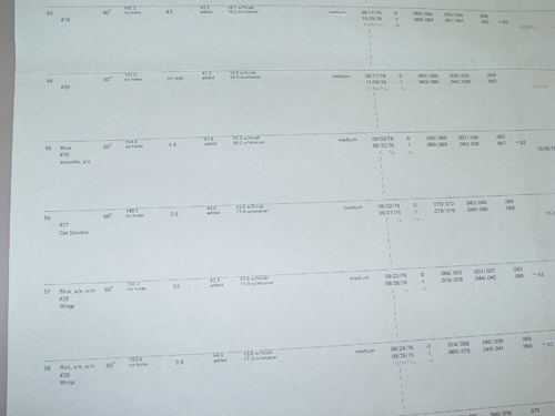

I do not have a plot like the one done a couple years ago. Back then they measured time with a calendar and motion/distance in cubits. Only additional information I have about this guitar pertaining to this topic is its fundamental resonant frequency - which is 93Hz. If it has opened up - I cannot prove it...not sure if it has...Over the 20 years or so I've had the guitar...the change would be so slow - I would not be able to tell - sounded good then - sounds good now. Professor - I'm still betting your OFC sounds better - I'm trusting 30 years of learning leads to something better....I'd bet at the very least the OFC is louder. I have personally found the best sounding guitars are the ones in which the PLAYER actually hits the notes precisely in time and in tune...a novel concept. Several years ago Phil Keaggy played #43 for ten minutes..trust me - it sounded much better then. You also have to remember - when the originals were made - it was a progression over time - with educated experimentation involved in the process (Bill - tell me if this is incorrect). The great art form is ....what response do we need from the guitar to make it sound subjectively good (measurement by one player with bias)...and what science in the process should be there - to consistently make a lot of them objectively good (measurement by lots of of players without bias). Man...can you tell I'm a HS principal in the summer with nothing to do but write? I gotta get back to work....maybe I'll buy some string tubes.

Yes I did take some pics of the "Master Printout" at the SlotHead Reunion in '05.
However, since it was so large (about 3' wide x 10' long) and that it was laid-out on a table, the "overall" pic doesn't show any readable details. By looking at some of the "close-up" pics it show various dimensions, weights, dates and such for each guitar. It lists the "Resonant Frequency" for each guitar, but that's about the extent of anything along those lines . . .

Thanks Cliff - great piece of history you have there...folks - I cannot jump to the conclusion that the resonant frequency in 1976 equates to the A and B measurements a couple years ago...it might - but I dunno...but it was freaky watching Darren run the video plot of the geetar...as Cliff suggested - - even Darren admitted through video analysis this particular guitar has some unique sound signatures...so be it! I'm guessing we need a prof. interp. Even if it opened up - it still doesn't help me play an Ab augmented flatted 9th with and F natural on the low E string!

Posted 2007-10-12 4:33 AM (#91922 - in reply to #91874)
Subject: Re: OFC GUITAR - LASER VIBROMETER PLOTS
Posts: 2793
Location: Atlanta, GA.
Finally scanned the plot of Slothead #0045.
I emailed Dave a Hi-Res copy.
