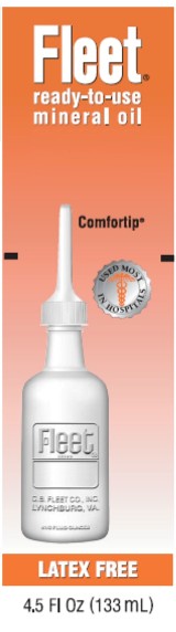

| noah |
Joined: December 2004 Posts: 1673 Location: SoCal | Originally posted by dvd: Fleet Laboratories has been the #1 provider of Pure Mineral Oil. ...His recommendation was to use the pure mineral oil located in the pharmacy/medicine dept...I picked up enough at Bimart to last me for years for less than two bucks. Musicians ask for it by name at their local pharmacy. ![]() | ||

Joined: December 2003 Posts: 1071 Location: Carle Place, NY | Originally posted by an4340: All mineral oil is not the same. What you want is heavy mineral oil. It's very cheap and can be taken internally as a laxative. Baby oil is light mineral oil. I've also used the Old English Lemon stuff and I've found that it works OK as a cleaner with very fine steel wool. Now I use mineral oil and I clean the fretboard with steel wool and a few drops of it. I do it each time that I change strings.I wouldn't use baby oil, because it's got scent put in it and other stuff. You want the mineral oil that you can eat when you're constipated. | ||
