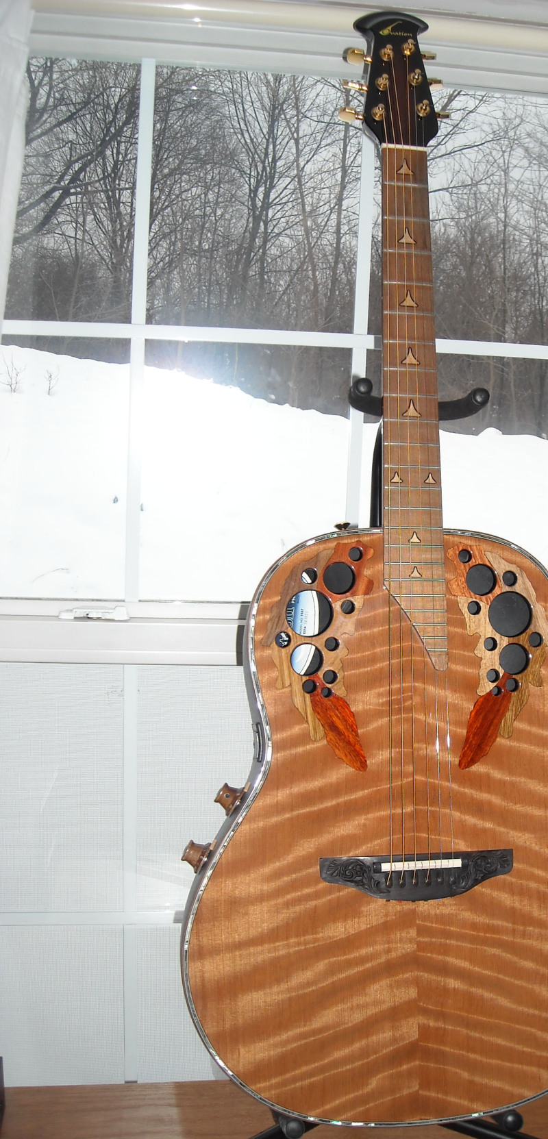

Hello. The guitar has all the regular Custom Legend inlays. It has the carved bridge and the carved truss rod cover, but there is only solid peghead under the cover, the truss rod adjusts at the body. Would this be common? It has a 1976 serial number, but it sure looks brand new. Here are some pictures.
(20250906_212656.jpg)
(20250906_212457.jpg)
(20250906_212503.jpg)
(20250906_212517.jpg)
(20250906_212529.jpg)
(20250906_212616.jpg)
(20250906_212644.jpg)

Can you show a picture of under the truss rod cover, and the truss rod adjustment in the bowl, please?

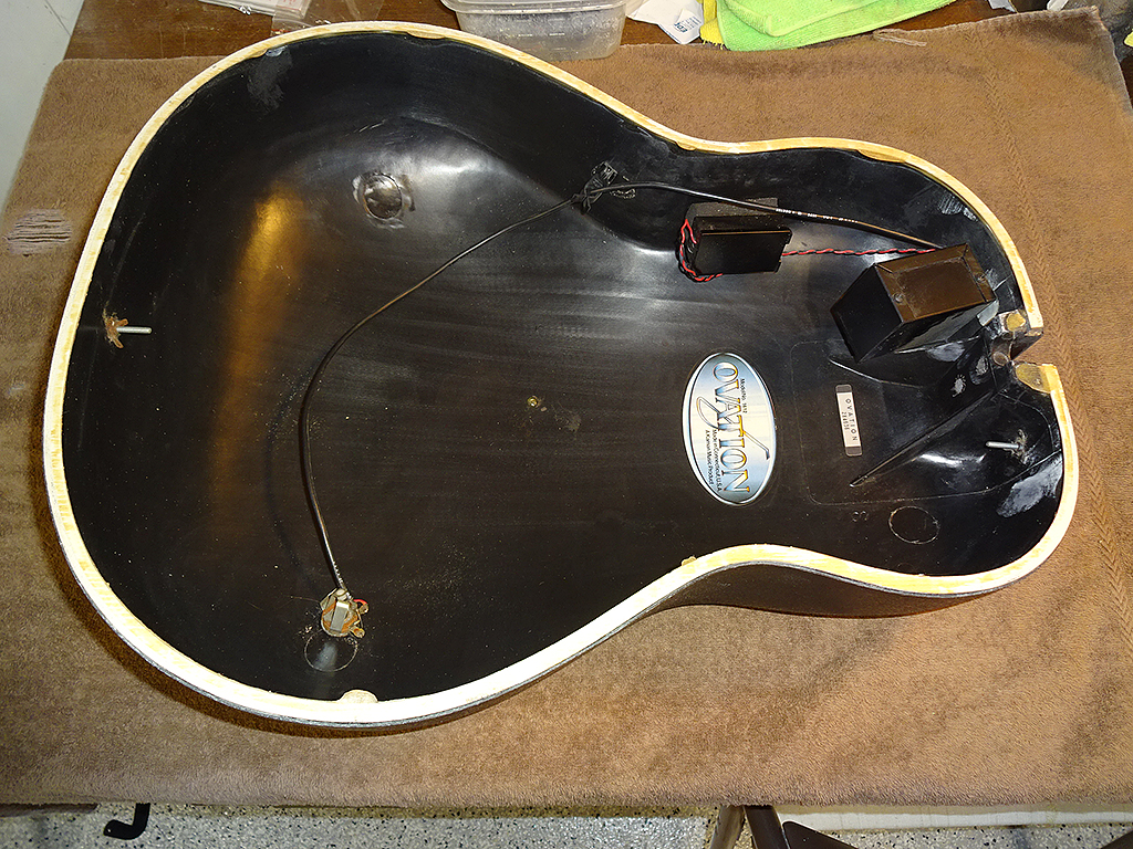

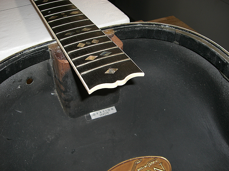

It's definitely an SMC bowl with K-bar neck. The `76 Ovations used hand-laid, woven fiberglass bowls and epoxy resin. You can see the weave of the cloth inside.
SMC bowls are molded using hot presses and polyester resin. The inside is smooth, just like yours.
Yours is assuradly not a 1976 model year guitar. If it were the inside would look like the photo below.
Don't get me wrong. Yours is still a very nice example of a CL. It's just not an original 1976 model.
It looks to me like they jacked up the label and rosette and replaced everything else.

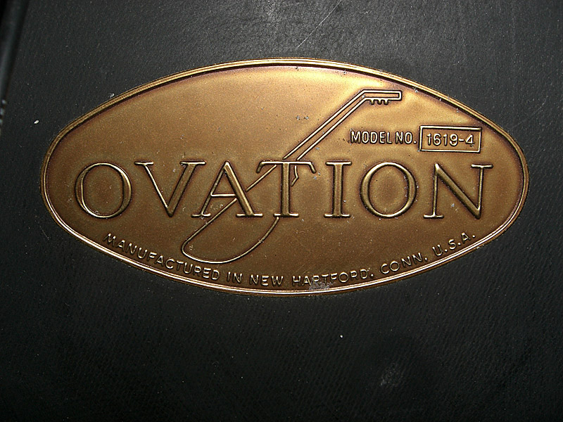

1976 Ovation guitars used stamped foil labels. All used silver foil except the CL which used gold foil.
In the photo below you can also see the weave of the cloth.
Yours has the later blue paper label. (1980s)

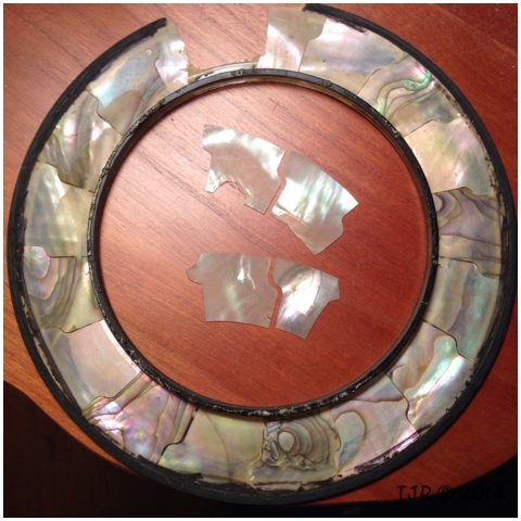

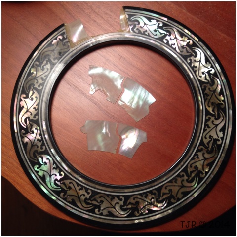

The rosette looks to be original, but beyond that and the label, everything else looks new.
The original CL rosettes were segmented abalone shells. This is what yours looks like it's got.
Later CL rosettes used printed abalonoid.
Edited by DanSavage 2025-09-07 5:32 PM

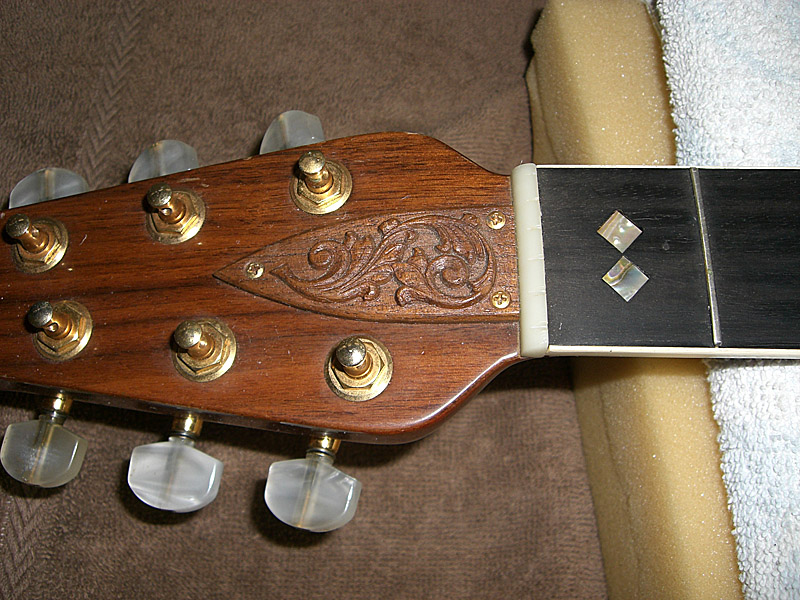

The TR cover is from the later, 1157/1657 Anniversary models, not from a CL.
Here's your TR cover:
Here's the 1976 CL TR cover. These did not change over the years.
FWIW, I used an Anniversary TR cover on my Black Pearl CL.
I didn't have a CL cover, so I used what I had on hand...
