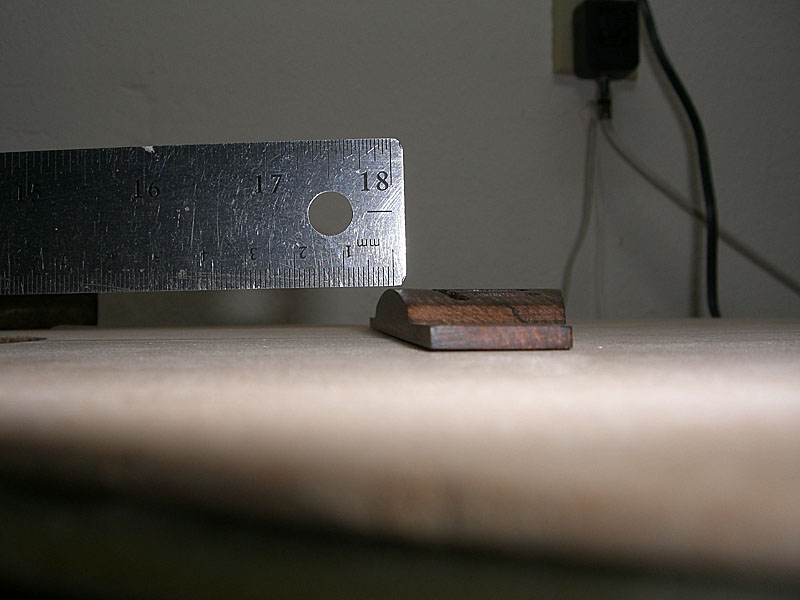

The fretboard extension has a tiny bit of back bow (visible in one of the photos) but I think this will be fine when it's glued to the top. Do you agree?

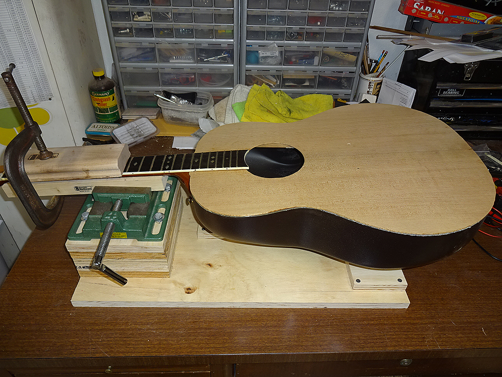

When I did my 1778T, I made the cross-grain reinforcement go all the way across the top a la the 1537. This required that I 'notch' the underside of the braces. That was unnecessary. The main purpose of the reinforcement is to ensure the top doesn't split between the sound holes.
As such, you only need reinforcement over the sound holes in the same way later Elites are done. The image below is from a 2078 TX.

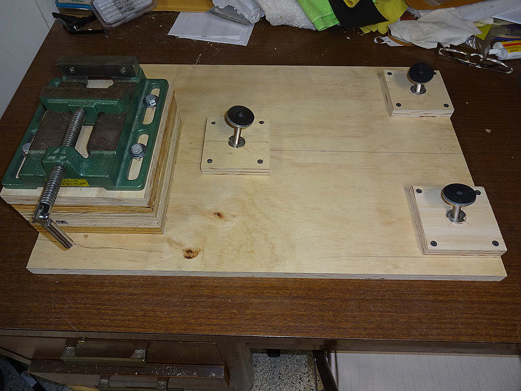

11. (Do I need to do something here with the bowl to make sure the neck is at the correct angle?)
I have a jig I made that simulates a tool used by the factory. I use this to set the neck angle when the top is being glued.
At one time I tried a bowl-bend using heat, but I found when doing Jen Chapin's 1613 that the neck angle can be reset when the top is glued. Once glued, the neck angle will remain the same.
Think of a Tupperware bowl. When the lid is off, it's easily distorted. Once the lid is snapped into place, the bowl becomes rigid. This is the same principle for Ovation guitars.

If you go to my Harry Chaping 1613 thread, page 3, I explain how I did the neck reset while gluing the top to the bowl. It worked so well, this is my go-to method to reset the neck. I tried a bowl-bend once, but the bowl eventually reverted back to it's previous condition.
In the photo below, the top is being glued at the same time the neck is being reset.
If you adjust the TR so the neck is flat, you can lay a straight edge along the middle so the end of it is near the bridge. On a properly adjusted neck, the straight edge should be just above the top of the bridge, like this:

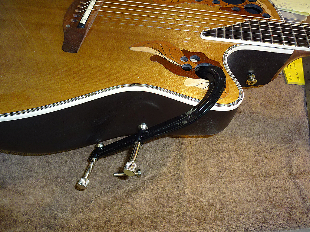

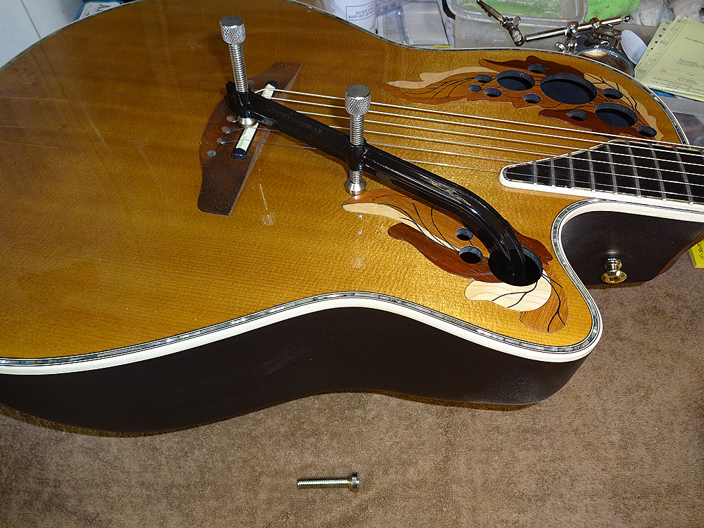

How do you guys set up clamps to glue on the freboard extension and bridge without a conventional soundhole? I'm thinking maybe use rare earth magnets?
On my 1778T, I used Stewmac deep throat clamps for the bridge. You'll have to remove the bottom adjuster to get it through the sound hole, then reinstall it once it's inside the guitar.

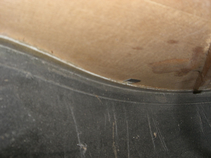

How do you recommend removing the top? Heat gun and putty knife, to take the binding off first and then the top? I assume the kerfing (or whatever is in there?) stays attached to the bowl and is reused?
The binding and purfling can just be peeled off without heat. I use an Xacto chisel to remove the top. It gets slid between the lining and the wood of the top. Since you're replacing the top it won't matter if the wood gets a little chewed up.
In the photo below you can just see the tip of the chisel.

door stop clamp
The above is on a mid-depth bowl, but the door stop clamp works on deep and super shallow bowls as well. Not exactly the precision Luthiery solution, but it works well with the Os I've worked on. If the neck joint is properly fit, there's no need for an enormous amount of clamping force to keep the fretboard extension in place. If the extension is not designed to be floating I'd definitely recommend against leaving the fretboard floating. If the floating is too bad, I think a shim under the fretboard extension would be advisable.

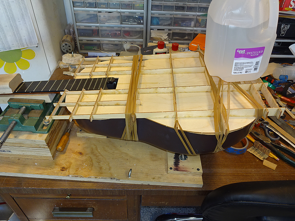

Oh and if you're going to take the top off anyway, you might try flatening it out after removal. My 1868 top looked like this when I first got it
1868 top warp
After stripping the paint and removing the top it looked like this...
stripped top
I was able to salvage, repurpose the top and restore my 1868. Repairing the warped top took a bit of time wetting and drying over several months, but the results were well worth it to me. Having said that, I would probably choose to re-top the 1768 if it were mine. Might be good to get the project under way and share as you go. The BFLG folks are highly experienced and always provide valuable insight. As far as I can tell there is nothing on your 1768 that isn't repairable! Good luck!
