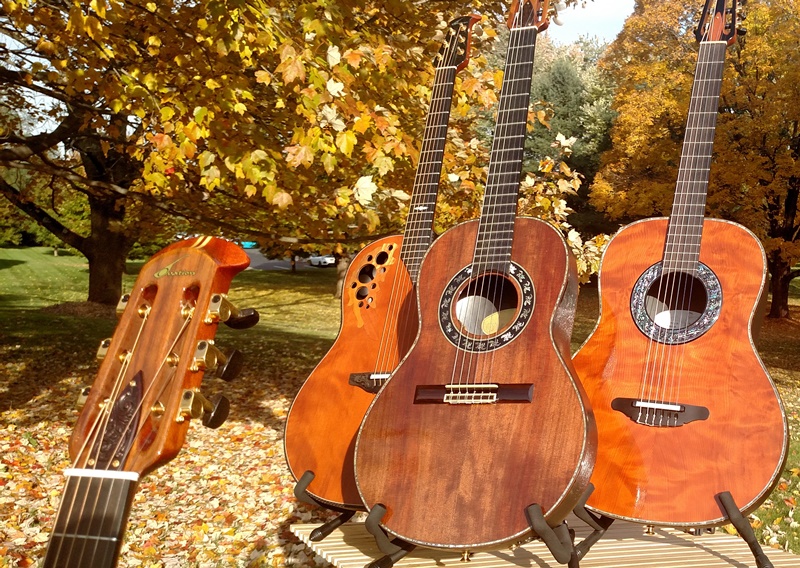

Here is a picture of the parlor he re-built for me with Sinker Redwood sitting beside my Custom Redwood 1713-X. When he built my nylon parlor, I was certain it would provide a marvelous counterpoint to the deep-bowl 1713. And I was right. (Don't you love it when a plan comes together? .... My son was watching A-Team all afternoon yesterday. Sorry ...) Both guitars are loads of fun!
The 1713 has an alarming amount of punch, and especially bass due to it's A-bracing. It can even stand up to moderate flat-picking when strung with high-tension strings, and I have to be careful with it when playing at choir rehearsal as it can overwhelm the other guitars if I get too aggressive, especially with its bass strings.
The parlor obviously can't match the volume of the 1713's deep bowl, but has a very balanced tone that is just a joy to play on the couch or deck. It's not over-powering, but it is just plain nice! However, a bit of information from Dan carried over to the 1713 in a way I had not anticipated: He told me that he originally thought the parlor was a bit bass-heavy (It's worth noting that it's bracing pattern is similar to an A-brace.), so he put a mixed set of strings on it; standard tension basses, and high-tension trebles. I had never thought of mixing tensions before.
He had no inkling of how bass-heavy my 1713 could be, but after hearing the parlor for myself, it was obviously worth investing a few experimental bucks in a mixed set for my Redwood. I tell you now, it made all the difference in the world! Finger-picked or flat-picked, the tones evened out immediately but kept its acoustic volume. And if I happen to want more bass, I simply ratchet up the attack on those strings and it rings right out.
The two guitars sound different, but as we all know, that's not a bad thing. And I admit, that when I feel like playing nylon, I sometimes have a bit of a struggle deciding which one to pick up.
