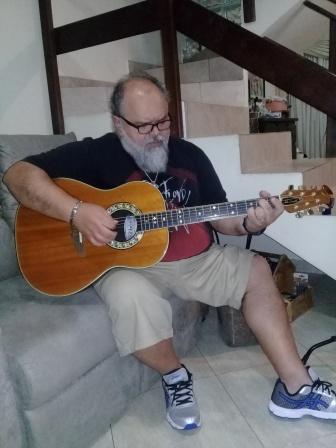

Hello. I need to change my Glen Campbell's damaged rosetta but I can't find it. I have found generics of poor quality. Can you give me a clue where to find it?
(ROSETTA_01.jpg)
