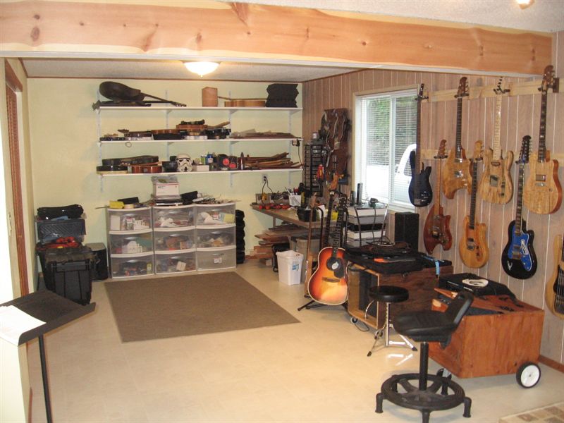

Anyone like to share details and maybe photos of your lutherie workbench? I have a general woodworking bench and am planning a few jobs e.g. fitting endpin jacks to 2 all-wood acoustics. Also need to be set up for Ovation and Applause roundbacks.

My "craft" room looks like a sharknado hit it... I suggest not letting that happen.
Of note - my work table is an ironing board, aka, a Mother tested ergonomic work surface if there ever was!

By the way I like your workroom, MWOODY. Is the beer fridge is concealed in one of the cabinets, or just out of the shot?
