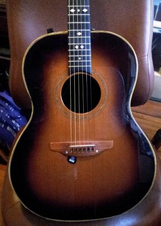

ChuckSurette
Posted 2021-05-13 11:18 AM (#555546 - in reply to #533677)
Subject: RE: X Braced Balladeer Repair
April 2017
Posts: 22
Retopped Balladeer
Almost home...
DanSavage
Posted 2021-05-14 5:22 PM (#555560 - in reply to #555546)
Subject: Re: X Braced Balladeer Repair
June 2012
Posts: 2347
Location: Pueblo West, CO
Looks good, Chuck.
What finish are you going to use?
