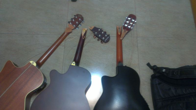

However, while I was away from Taiwan, the three guitars I repaired last winter de-glued!  My wife said she was sitting in the living room and suddenly a “prang” sound came from the office and upon inspection found the guitar decapitated.  The other two I discovered the week I got back to Taiwan and my co-worker handed me the remains. I have been putting off their resurrection attempts until now…or in the nearer future looking at my schedule ahead.
a picture of the carnage...oh the horror!

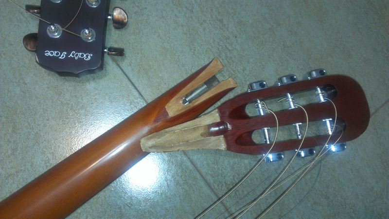

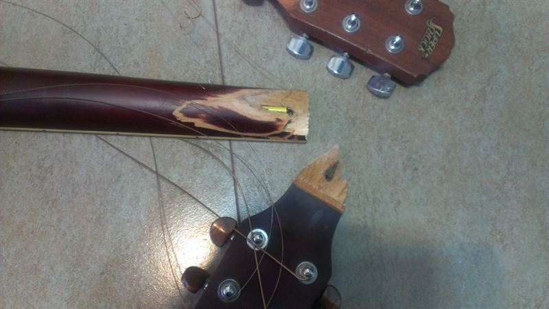

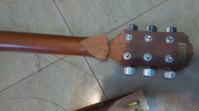

Here are close ups of each of the broken heads.  Two are pretty clean and one was like putting a puzzle together the first time.  I'm guessing it will be harder to take apart.  Unfortunately my co-worker says that is the one with the best sound.
