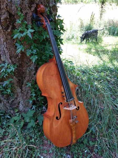

Woody is getting into string theory so I'm going to try and pst pictures of one of a hupthosis that occured to me. The donor had the neck broken off in 3 pieces, the body wasn't much better.

That is luscious!
You have tucked the Preamp under the fretboard where the bow hand can make quick adjustments - mind blown!

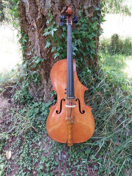

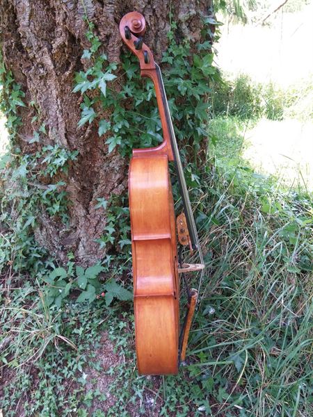

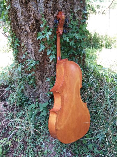

Thanks for posting the pics Damon, it is a odd process...
The electronics are actually passive to use outboard gear but it is wired in stereo like my archtop so the acoustic and magnetic pickup systems have their own processing paths. The idea was to design a system that could be fitted to an expensive cello without putting holes in the carved top and body so it has suspended exterior wiring running under the tailpiece. The 5 string conversion and cutaway were things I wanted in a cello. I had some nice birdseye maple sitting around so used it for the tailpiece and pickup/controls parts. Refinishing was done in varnish like good string instruments, a upgrade for this old battered 50s Kay.
I'm interested to see what you come up with Woody, I like the bowl idea. Once you plug in it doesn't need a full size body but I'm sure you could nip, tuck and combine to get whatever you want.
