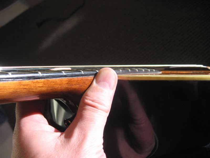

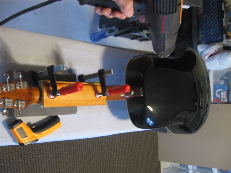

Having practiced on Lyrachord left overs and having some success on a 1615 Pacemaker I thought I'd try a bowl bend on Deluxe Balladeer Serial 1096 which had gone back to the Mothership some time ago and received the maximum benefits short of having to decide to keep the top or keep the body... I kept it all and thanks to Mr. Budny and company it came back patched and buffed with a slightly high action.

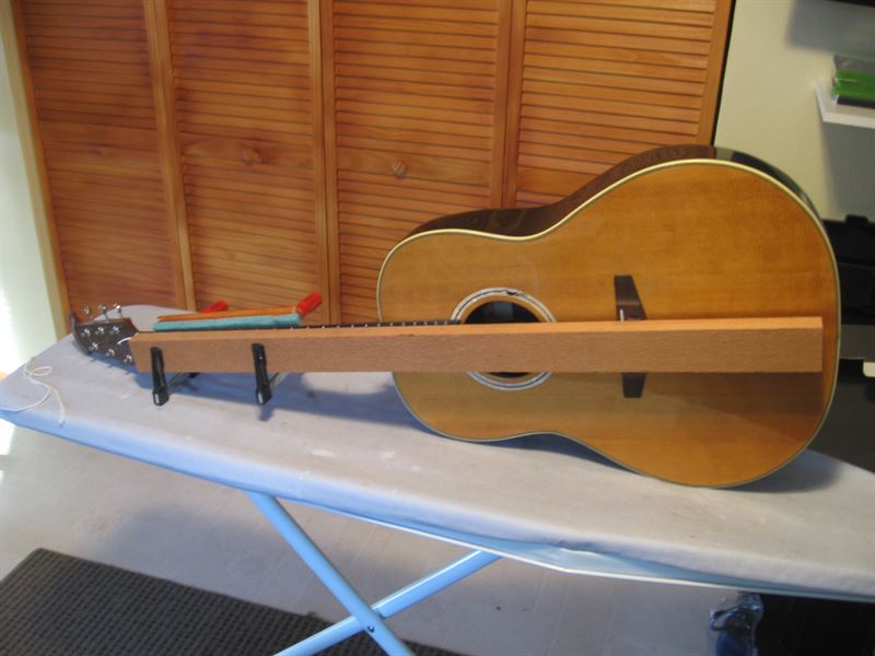

Do not expect any "Dan Savage" level jigs or fixtures... just some simple physics, a $10 laser temperature gage and my trusty Mother Tested ergonomic Work Bench (ironing board).
What I learned was that the early glass bowls don't go to "Plastic" until around 250 degrees F and my next attempt will require three people. Two heat guns and someone wearing oven mitts to tell when an area is ready to bend.
The net result was a gain of the the strings riding 1/32" closer to the fretboard at the 12th fret.

It amazed me how the material was really good at dispersing the heat I was applying. The trick is to use the heat gun set at 1050 watts to heat the material to 250 f but without bubbling the paint (over 300). I could only work one side at a time.

Nice job! I like your fixture and your portable workbench.
Ha ha! The only reason why mine was so 'advanced' was that because I had removed the top I had to make sure the bowl didn't twist when I softened the bowl.
