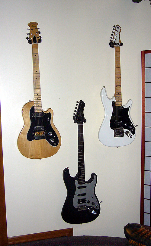

Posted 2007-12-15 6:35 PM (#70218 - in reply to #70212)
Subject: Re: Help: Hercules Wall Hanger Spacing
Posts: 7248
You can also stagger them vertically for even closer mounting. Although these are mounted face out, you can see where staggering would make an impact if they were at an angle too.
