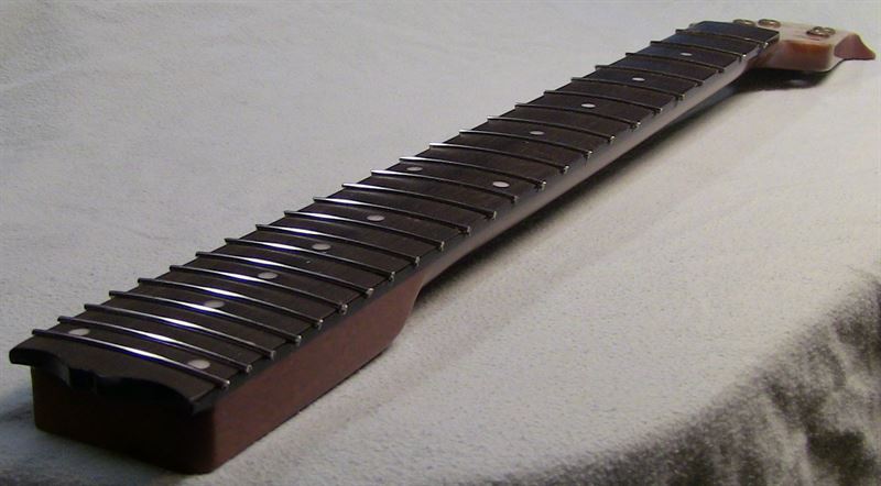

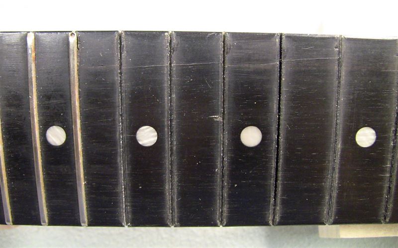

This guitar needed a refret and a new nut. I learned a lot re-fretting an old acoustic first, and this Viper turned out really well. If anyone is thinking about doing this kind of project, you can do it but you'll spend a fair amount on tools and materials. I still have at least 2 other guitars to re-fret in the near future.

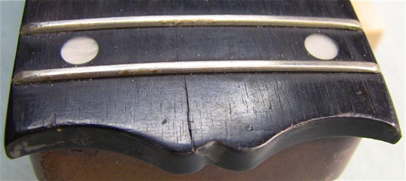

The frets had been filed low in the distant past, and now also had some wear in them. The wood showed a lot of wear.

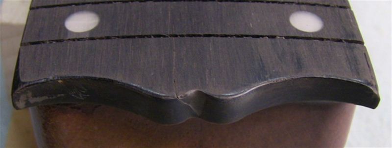

I don't know if these were the original frets, but they were installed with hide glue.  It was a bit of work getting all the glue out.  Finally I resorted to using a fret slot saw.

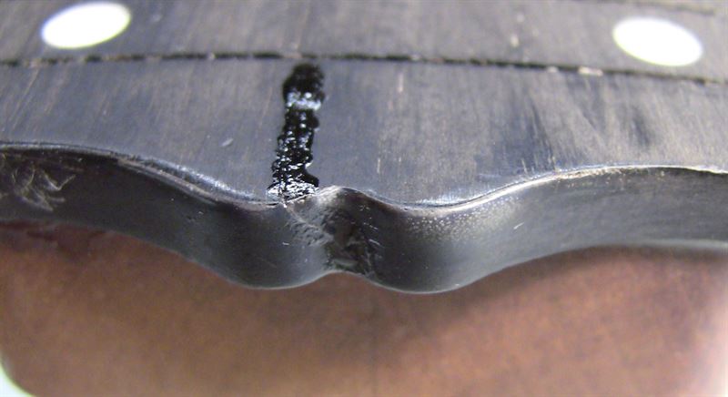

There was a crack in the end grain.  I sanded it, then wicked thin cyanoacrylate glue into it, then sanded the excess.

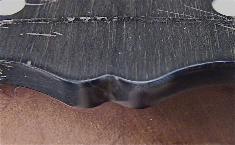

The next step was to sand the entire fingerboard with progressively finer sandpaper using a radius block (a piece of wood with the correct radius). The ebony took on a mirror finish by the time I got to the fine polishing pads.

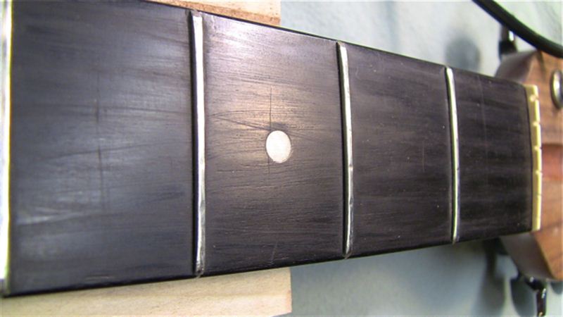

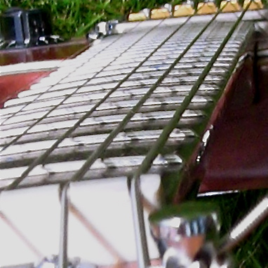

Once all the frets are installed, the ends are nipped off and filed flush. The key to this step is to use the angled file to get the ends beveled all the way to the edge of the wood. If you don't bevel enough, the ends will never be flush with the edges of the wood.
Here's a look down the edges of the new frets after the job was completed.

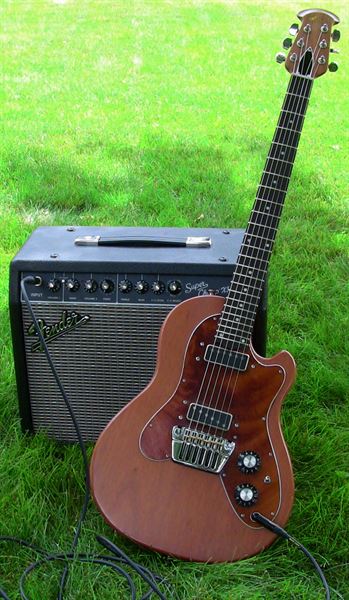

All done!
