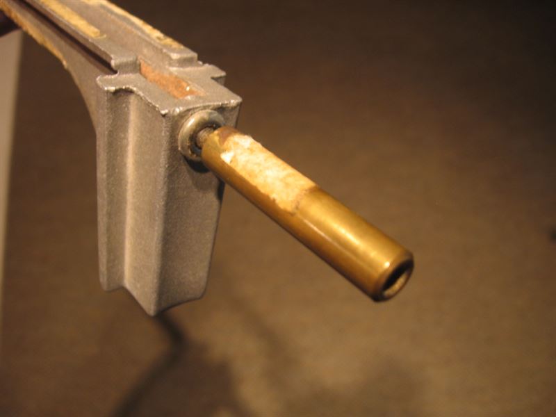

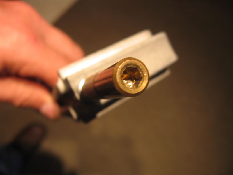

| MWoody |
Joined: December 2003 Posts: 13997 Location: Upper Left USA | So what you need is one of these? Please send me round trip tickets to your Villa and I would gladly install it...
Or PM me your mailing address and I can send it to you.

| Old Man Arthur |
Joined: September 2006 Posts: 10777 Location: Keepin' It Weird in Portland, OR | What I think that he really needs is the NUT for the end of the Truss Rod. As I remember from my Pacemaker, the nut is longer (wider?) than a normal nut. But I am thinking that a regular nut would work, provided that you had a Deep-Well socket to tighten it. Also, a stack of washers might help like previously mentioned. | ||
| paofab |
Joined: November 2011 Posts: 35 Location: Italy | Thanks Old Man Arthur for posting the picture, I've tried with no success. What I need is exactly the part number 10. | ||
