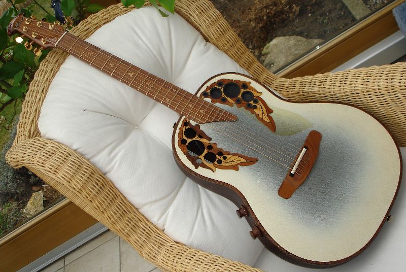

Hi folks,
my Adamas II had to make a ride back to the mothership for refurbishment. Recently I got it back and as always they did a great job!
Inspired from the Adamas 1680 model I wanted them to use gold fretwire. And I'm more than pleased with the result. The colors of the walnut and frets match perfectly, the gold looks very organic. No difference soundwise (at least to my ears).
BTW: This Adamas is one of the rare 1682 models which features the real 1 7/8" neck. Very comfortable to play, I prefer this width to the others they offer.

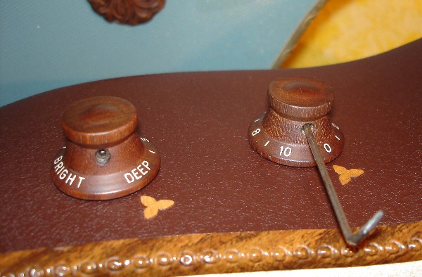

I also upgraded it with the reengineered two-knobber electronics. In contrast to the old electronics the new one is very lightweight.

Very nice that the walnut knobs can stay in place and new electronics run off of these?? is there a push pull feature?? Or??

The original electronics worked but the reissue electronics has some adavantages which are worth the effort and money: It produces less noise and is extremely leightweight. I immediately noticed the reduced total weight of the guitar.
You can still use the original knobs. You just need a 1/16" Allen key to unscrew them.

(anybody notice the half-set of AirLox in the top pic??)

Yeah I noticed the airlox ... but I call them bung hole covers.

Beal, while the original electronics were state of the art 30 years ago, they ARE 30 years old. When Ovation built the reissues, they also tweaked the electronics for modern performance. I think that along with being quieter, they also sound warmer.
Karl, the old knobs don't fit the new shafts. The shafts of the new 2 knobber electronics are slightly wider than the old 2 knobber shafts.

Subject: Re: Gold fretwire on my Adamas II
That's a Nice One Karl!
I hadn't seen that White fade to Blue before...
Or is that Blue fade to White?
Either way, It's Purdy!

Paul, you're absolutely right with the potentiometer shafts, I neglected this in my post. It took me five minutes to file the aluminium shafts to the proper diameter for the original knobs. I definitely wanted the original ones as they look better due to the naturally aged wood.
Right Cliff, I locked the bung holes only on the treble side. I have no idea why but in this configuration I get remarkable more bass (especially from the E string) out of the guitar. This also works with the OFC guitar and #47RI but not with my standard Adamas I (1687). Any ideas?

You're funneling the air thru the bass bouts - hemce, more bass response . . . why it doesn't seem to work on the other guitar, I have no idea . . .

Have to agree on the bass response, it should work. The only thing it could be is that there's something interfering with the guitar's internal air flow. Some one here had a fancy name for it. But I forget.

Hemholz frequency.. or something to that effect. Paul Temp. will correct me.
Posted 2008-01-24 11:45 AM (#59837 - in reply to #59817)
Helmholtz.
