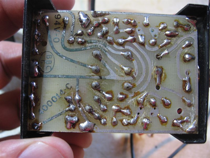

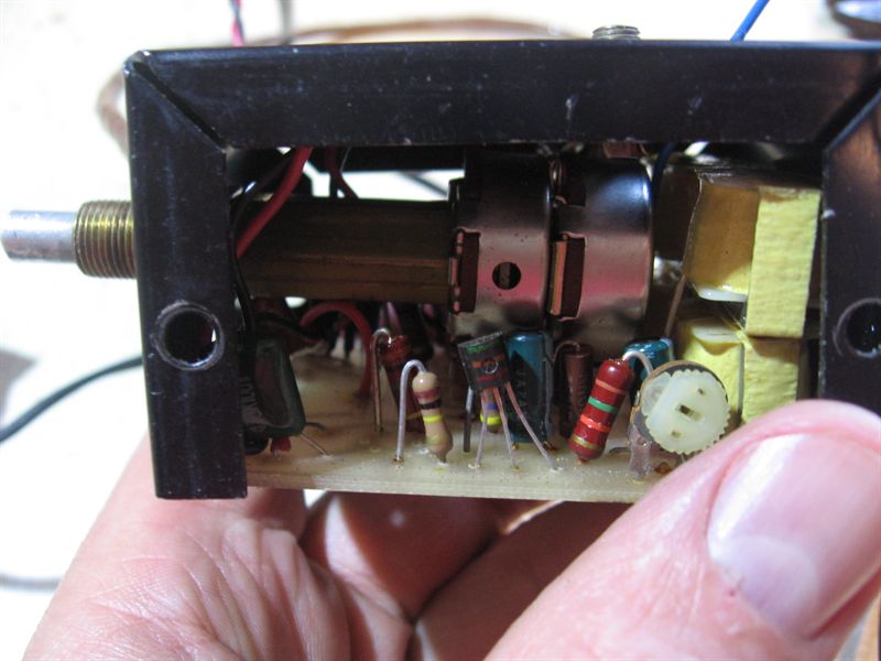

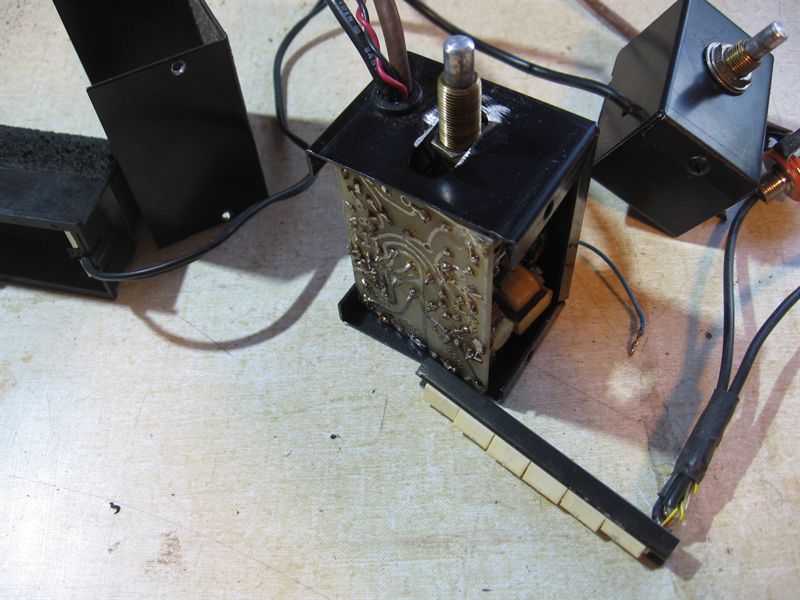

So this conversation needs some pictures. Here's a two-knobber that someone tried to fix before I got it. Look at all those little "hard-to-replace-ems" in there!
Some tattle-tales on the circuit board.

Ok, that's one of the older ones. Connections were soldered. On the reissue units, the parts were modular and plugged into each other. From the pick-up, there are two wires that plug into (1/8th"?) the preamp (the tone box). That seems to be where the problem is.

I had similar problems with #43 in the 80s. To be able to finish a tour...I actually dug in there...and soldered the actual plug tip and sleeve separately to the jack points...real high content silver solder and a very hot iron. The only way that connection was every gonna become oxidized through to the points was to actually cut the jack points with wire snips...which is ultimately what the mother ship did...I had an OP-24 put in...it became much quieter, and a little more flexible...and a ton more reliable. On the old ones, I think it is those two pretty big capacitors (blue ones in the pic) which hold static a good while so close to the rheostat, which creates a small magnetic field...and so build happens quickly...I am guessing they found a way to drain the static away through better grounding in the OP series models...though I actually do not know because I have never...and I mean never had to open it up again.
