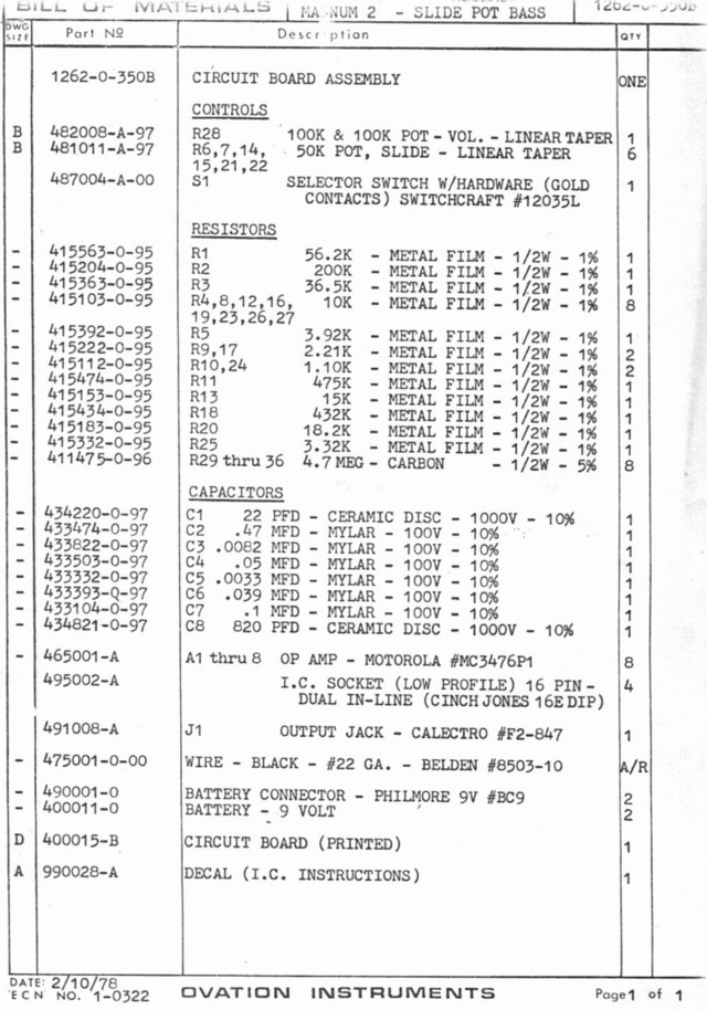

schematic:
parts list:

Does the MagIV schematic/PartsList differ drastically from this one?? (just curious)
Paul Templeman
Posted 2008-02-04 9:26 AM (#56832 - in reply to #56828)
Subject: Re: Servicing a Magnum II?
Posts: 5750
Location: Scotland
Don't think so, the only changes were the shape of the body and the thumbrest/pickup surround/string mute, I'm pretty sure the electronics were identical.
