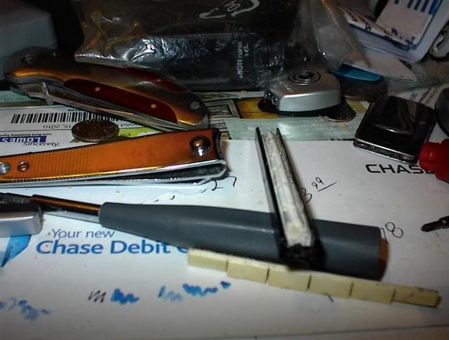

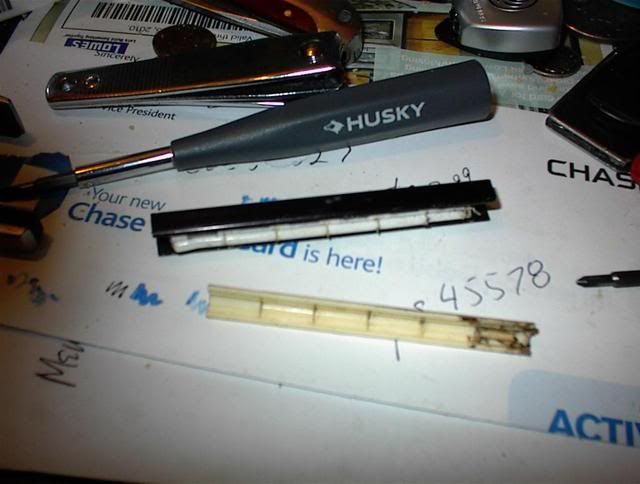

I found some old photos that I had on Photobucket that may help.
Basically, the actual saddle just "clips-on" to the metal "frame" that is underneath the pick-up.
These photos are of an old, broken, pickup that I sent off to a member (I don't remember who).
This is the saddle out of the pickup, and on this you can see the underside of the saddle where the original pickup was fried.
On this end view you can see how the metal base-frame has a bent-over lip on the edge that goes over the edge of the plastic saddle. You can also see the curved edge in the photo above.
And here is a photo showing the putty-rubbery-stuff that is under the saddle.
The piezo elements are in there somewhere.
The tools that are lying around are the precision screwdriver that I used to pry it apart.
I say "pry" but it isn't that difficult to get it apart.
When you take the whole pickup unit out of the guitar, you can remove the black end-pieces from the pickup assembly. The black pieces remove by lifting them straight "up". There should be two pins sticking through the metal frame... If you push on them from the bottom the black thing will come "UP".
Once you take that end piece off it would be easier to remove the old saddle.
Once you have removed the old saddle it is easier to understand how the new one goes back in.
I am not sure if it matters which way you put the saddle back in, but match them up to your old saddle. I can see that both "E" saddles are off-set, but it might matter which way it goes in.
Hope that helps.
