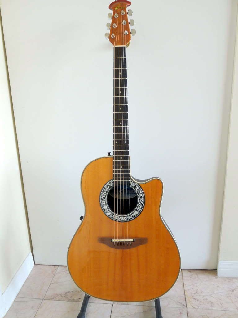

Hy guys,
I've heard people describe Ovations as sounding like "a spare tire with strings" ... I currently have three and I beg to differ. But I am wondering as to what you think is the reasoning behind the roundback design?
Here is my idea: I don't think it has anything to do with focusing the sound towards the sound hole. That would not make sense for the Ovations without a soundhole. I think the reason for the roundbacks is for better player comfort ... and also to eliminate the need for corners and seams. The entire back and sides are one piece and therefore is able to resonate better as a whole. And this is what gives Ovations their "sound"
What do you think?
1761 Balladeer

It's explained pretty clearly in the Carter book. Ovations came out of a need for an aerospace company to diversify into other markets. They worked with fibreglass and spruce in the manufacture of helicopter rotor blades so when they decided to build guitars they worked with materials that were to hand and with which they had experience. The first few fibreglass body prototypes were a regluar flatback design, but they were floppy and needed braces like a wooden guitar. So they went to a bowl design because that structure is self-reinforcing (the eggshell principle) and did not need to be braced. Pretty much everything else, including "focusing soundwaves towards the soundhole" and "braces interupting soundwaves" and "sound gets trapped in the corners of standard guitars" and the rest of the crap that was sold as "science" is essentally marketing BS

I realize that "focusing the soundhole" etc... is BS, that is not how an acoustic guitar works. The whole acoustic in unison works like a speaker to vibrate the air around it.
My point is that you can't tell me the age old design of a typical acoustic guitar is the best design for acoustics. Like you don't see too many other designs that have remained unchanged for hundreds of years...
