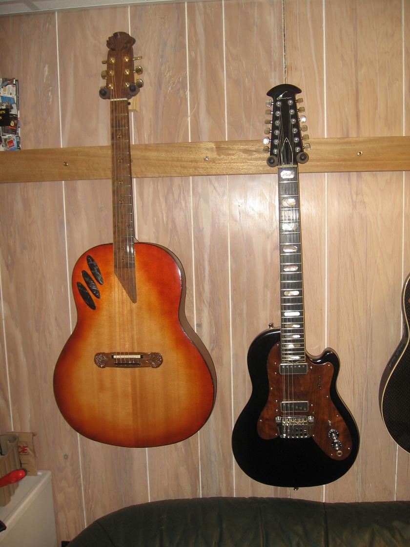

That chart was plucked from the OvationTribute site of Jerome's.
http://www.ovationtribute.com/Ovation%20Parts%20Catalog/Ovation_Schematics_Diagram/Ovation_Silidbodies_Pickups.jpg
 I've never seen a Viper 12 so I had to make one.
Along with a Jumbo Adamas...
Edited by MWoody 2013-09-25 1:24 PM

MWoody - 2013-09-25 11:21 AM
Woody...How much trouble was the 12 string conversion on the viper? I'm interested in doing something similar with a viper. Any info on the build would be very cool.

RE "How much trouble was the 12 string conversion on the viper?"
Not hard at all. The Neck pocket will need to be shaved a little larger but the rest is pretty straight forward.
I used a sharp chisel. You can route or sand if you want.
The hard part is obtaining a 12 string neck and bridge.

Isn't the Preacher neck like 1 3/4" shorter than the Viper neck? Wouldn't you need to move the bridge in order for the intonation not to be way off? MWoody I'm wicked curious and would like to make one.
Posted 2014-10-03 7:18 PM (#494651 - in reply to #476406)
Subject: Re: Viper 12-String
Posts: 13996
The Preacher is a 24 3/4" scale and the Viper is 25 1/2" so the difference of 3/4" can be made up for in the bridge adjustments (and neck length).

Posted 2014-10-04 1:49 PM (#494672 - in reply to #494618)
Posts: 7247
danomyte - 2014-10-02 12:30 PM
Pic
I miss this thang... The person that bought it from me had to really talk me out of it.
