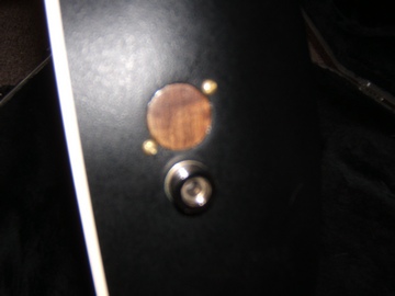

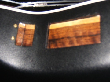

I have an Adamas w591 I recently bought at a bargain price - but without the Optima preamp. I was also lucky enought to pick up the preamp, battery box, pickup and xlr via eBay and it's on its way. When the prior owner pulled the electronics out, he also installed what we think is a passive IBeam. But here's where I need advice. He also glued wood from underneath to fill the holes left from the preamp, battery box, and xlr. I haven't tinkered with it, because I wanted to be sure I could get the replacement parts. Any advice or techniques anyone might have for removing this wood. The pieces are not flush with the cutouts, just behind them. I'm sure a luthier would be able to do this, but thought I might do it myself and of course don't want to damage the guitar.

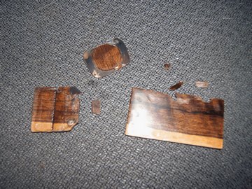

Wow, that was easier than I thought. I took the strings off I reached inside and felt that the glue the guy used to glue the wood to fill the preamp cutout, battery compartment and xlr opening was relatively soft and silicone based. A couple of easy blows to the wood from the outside pushed the pieces in enough to pry the wood out of all the openings. Any glue residue peeled off clean as a whistle. I installed all my new components and am just waiting to receive the tru-balance pickup from John. I'll just plug it into the preamp and be done!

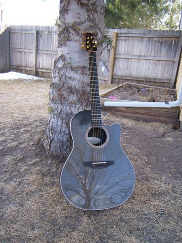

Here are a few pics.
http://www.ovationfanclub.com/photos/GregTaylor_35820_Imported%20Ph...
http://www.ovationfanclub.com/photos/GregTaylor_35888_Imported%20Ph...
http://www.ovationfanclub.com/photos/GregTaylor_35683_Adamas%20for%...

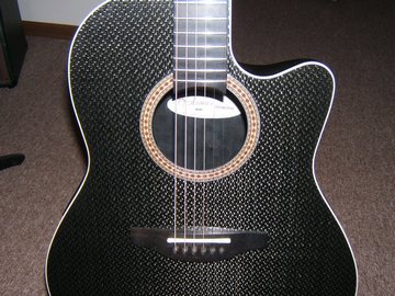

Aside from that, in the photo that shows the rosette - I've seen seen a few pictures of w591's on the net (they're hard to come by) but have yet to see one with this rosette. The one's I've see are really plain looking. I think this one is very nice. Also, I noticed that on the other gits I've seen, the end of the fretboard is not contoured to the sound hole - not straight across - but if mine is concave the others are convex. Anyone know why mine is different? I think mine was built in 1999.

here's a few more photos -before and after
