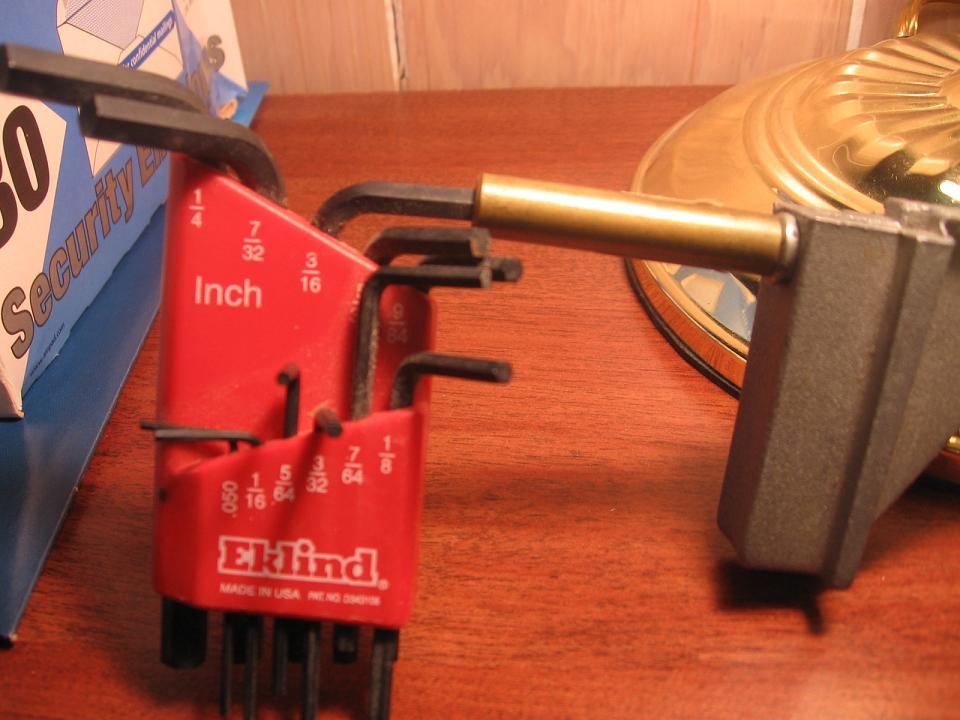

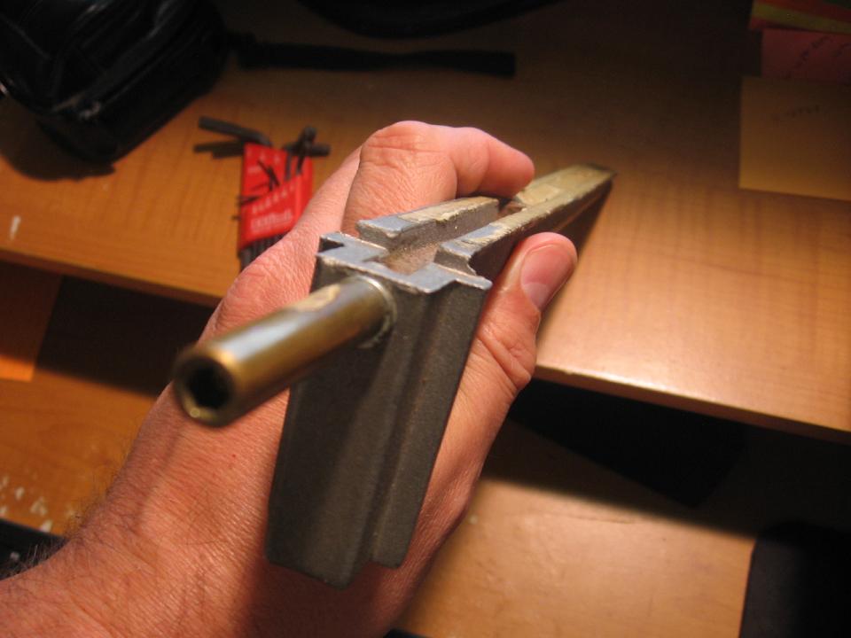

I also want to add this pic to give you an idea of what you are dealing with inside...
Your truss-rod probably doesn't have a large head like in this photo.
But those two "attach points" have hex holes (whatever) for an Allen wrench.
You do not want to remove them.
