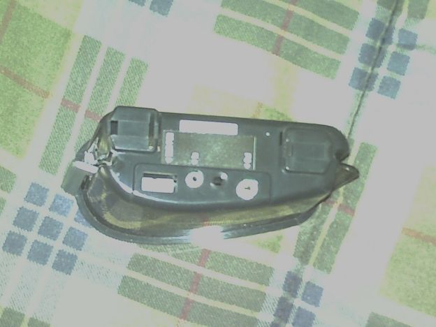

If you take the "can" out and look at the back, there should be a rectangular hole with pins in it...
That is the socket for the XLR card hookup...
If you can does not have that hookup, you would need a new can.
Once you have the Kaman card with the XLR and 1/4" jacks, you must carefully cut the bowl to situate the card properly. You also must be sure to get the correct XLR cable, because not all cables work with the Kaman XLR.
Something about which pin is the ground or is it the shell.

@ Old Man Arthur- Yup, the back of my can looks just like the one in the photo, so I'm good to go. The ribbon interconnect cable comes with the board, and I got a really, really great deal on it. Haven't had any luck finding the template for the hole I need to cut in the bowl online- it appears to be offline these days. If anyone still has a copy of that template and can send it along to me, I would certainly appreciate it. Naturally, I can and will make my own if need be. I'm aware that placement is critical and it's better to start smaller and work your way up to proper sizing :-) Oh, and Damon67- a DI box is not what I'm after- the big selling point of the XLR is the phantom power option- I have had one too many batteries fail or go anemic during a gig, and the OP-PRO distorts quickly after the battery drops below 9V. Having a guaranteed good juice supply for the preamp is what I'm after; I'll save the battery for the tuner...
