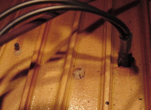

Mark, I went into it blind. After injuring my arm, it was the first hand work I attempted. It was a physical challenge and became real personal. When you wanted to buy her, I was so proud to share my triumph. Your guitar was the mountain I had to climb. When Moody met me, I think my hand and fingers were still braced.
The most intriguing thing about your guitar is the un-buffed clearcoat on the underside of the top. Despite the obvious abuse it sustained, there were no finish cracks. My other 1537 has a finish crack coming down from under the floating tongue of the fretboard and the underside of its top is bare wood. The 1337 (acoustic only), which appears to have had an active life, has a very light underside coating and has not developed the typical finish cracks. We started talking about it once before, but no one from the Factory chimed in with any thoughts behind the underside coatings.

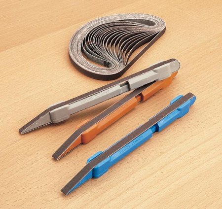

seesquare, these little (spring loaded) sanding sticks turned out to be more convenient than "my" fingers.
