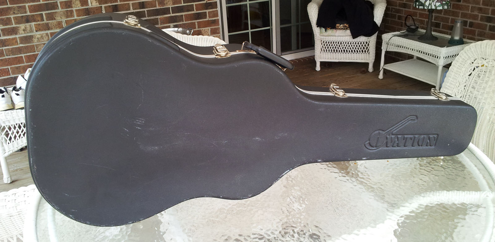

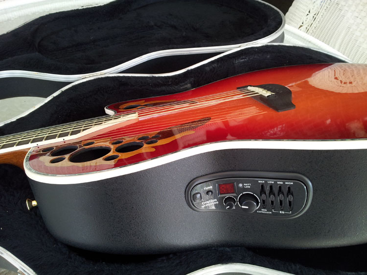

Joined: November 2012 Posts: 135 Location: New Bern, NC | Thanks to muzza I have figured out how to upload photos, although they may end up very big. Sorry about that. I'm practicing. Here is the case that came with my Custom Elite 2078 LX. The guy who sold it to me said the bottom of the case had the crack when he bought it from someone else. I wonder if this will effect the safety of the guitar inside. Should I consider a new case? Recommendations? And see the bottom photo too. Somebody help me with this thing please. Apparently it needs a battery, but I don't know how to replace it. Oh yeah, and how do I replace the battery in this?? I have no idea who to use it and I can't find anything online that resembles a "user's manual." | ||

Joined: September 2012 Posts: 815 Location: Thredbo, NSW, Australia | To access the battery you press the release button, which is the big button at the end near the tune button. The pre-amp will pop up a bit, and you can then remove it. They can be a bit tricky to get started. The battery is at the back of the unit. Take care when you reinsert the pre-amp. Make sure you line it up carefully before pushing it home. Insert the wide end first to engage its keepers before pushing in the narrow end. Nice guitar! I have the 1997 model - love it! | ||

Joined: January 2009 Posts: 1249 Location: Texas | May not be the same Pre Amp, but close enough so you should get the general "iDea" (I'm here all week) right HERE Edited by jay 2013-03-31 3:36 PM | ||

Joined: September 2006 Posts: 10777 Location: Keepin' It Weird in Portland, OR | Meredith, you need to re-size you photos and preview before posting. Really large photos make the whole thread hard to read. And be careful when putting the preamp back in... Make sure that the right side goes in first. | ||

Joined: April 2010 Posts: 823 Location: sitting at my computer | Meredith, that case crack doesn't look that bad (I've seen worse). Did you ask the MS tech what (if any) patch method they'd recommend?
I saw in the archives a post from seesquare, stating that Bondo worked "great" for case repairs and (eek) bowls too. Places like AutoZone, Discount Auto Parts and Sears automotive sell Bondo kits. I don't know if it'd be strong enough for remounting the case footpad to the same spot though. ?? Any case repair gurus out there? | ||
