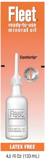

Dan, Where did you get your bore oil?
Bore Oil... for woodwind instruments (NOT purchased at PepBoys or Guns R' US)... purified food-grade mineral oil... tasteless, odorless.
Some bore oil labels say, "Warning: Contains petroleum distilates. May be harmful if swallowed." I would not use them.
Not all mineral oils are the same. Look for labeling like, "food grade" (in the US, FDA determines "food grade"), Butcher block & cutting board oil, Mineral Oil USP 100%.
Here is Mineral Oil, USP 100% in a convenient applicator bottle. You can pick it up at your local WalMart.
Posted 2013-03-19 5:42 PM (#468549 - in reply to #468419)
Subject: Re: ovation maintenance question
I bought a bottle of this stuff back in 2008 for about $2.
Now it has expired, but I still have a bunch of it left.
I'm guessing that this is Food Grade, and it don't stink.
