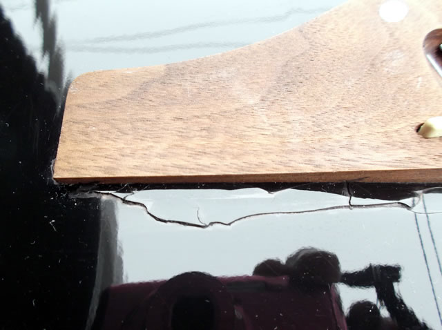

I have a 6751 which is probably about 10 years old and found that the bridge has lifted off and it looks terrible. I had a local luthier look at it and at first glance he thinks that part of the soundboard may have split off as well, and that repair may be costly. He will inspect it in more detail and get me a quote. I REALLY liked the action, playability, and sound of the guitar, but I am concerened about structural integrity as I already had the bracing re-glued and top straightened about 8 years ago and am wondering if instead of putting in another major investment I should just sell it as a project or for parts, and put the proceeds toward a new instrument?

As I may have mentioned in other threads, I was fortunate to get a 2006 6756LX in mint condition and register it as original owner, so I am quite pleased with that. In the meantime I had the Balladeer with the local master luthier, and I finally got an assessment. It seems that it was not the bridge that has lifted off, but due to storage in dry conditions and temperature effects the soundboard below the bridge had cracked and lifted partially off. He assured me that he can reglue and reinforce that damage for around 140 to 170, so it will be playable and stable again. But there would be very visible cosmetic cracks in the finish around the bridge which would be much more expensive to repair.

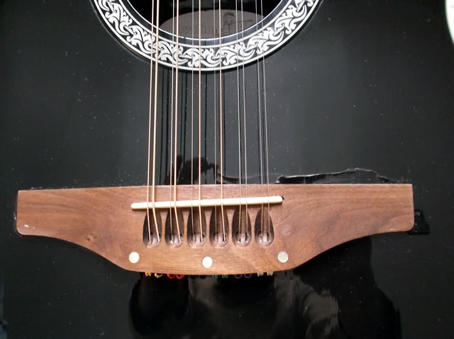

It has taken well over 2 months but I have finally picked up the repaired 6751. She sounds great with a fresh set of strings, but the bill indicates that the truss rod was adjusted and action may be a bit higher than before, but still pretty good. The bridge had been re-attached with three bolts against a maple plate at the inside and looks like this now:

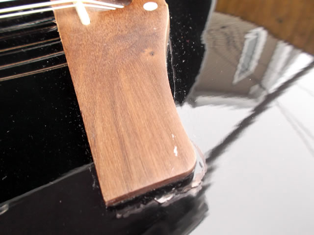

As promised, he did not address the cracked finish, but assured me that this is purely cosmetic:
Also I find that the soundboard is now slightly wavy behind the bridge and also seems to dip toward the area in front of the bridge. I have inserted an oasis humdifier and hope that this will improve the soundboard, but I am not optimistic.
