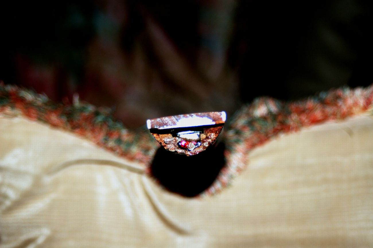

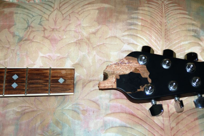

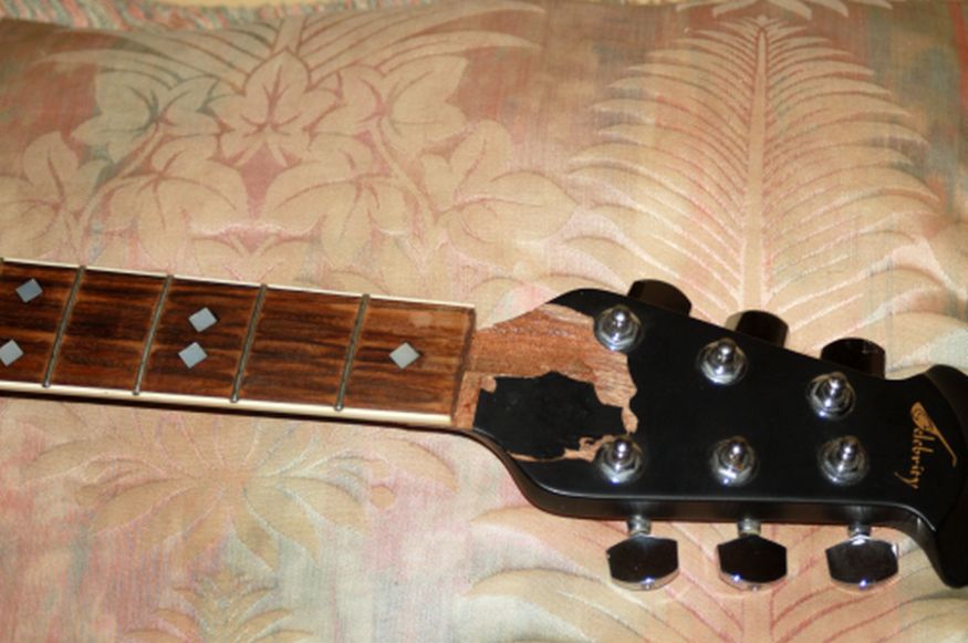

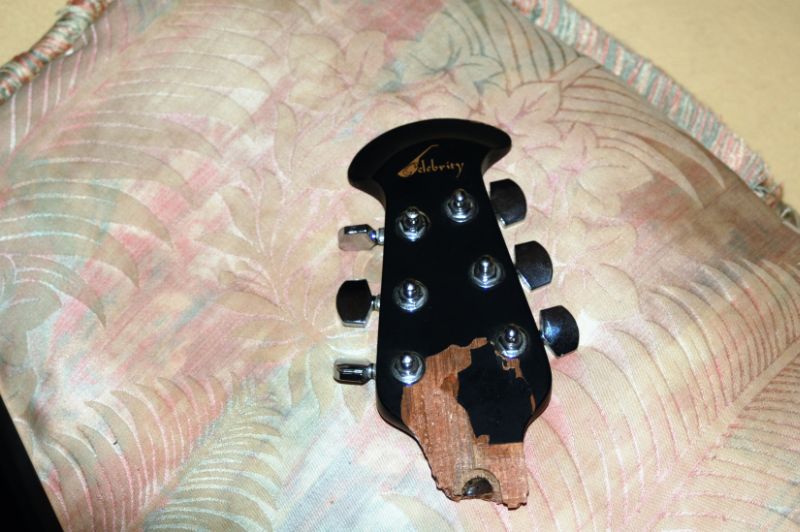

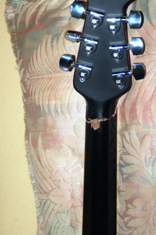

Thanks to Old Man Arthur and seesquare. Per your suggestion I am posting some pictures of the neck.
Any other suggestions will be appreciated. Another question is the type of finished used on the neck and peghead. It is hard and thick. I am guessing epoxy paint.

That's not a pretty picture(s)! :eek:

Whoa...Dude? :eek: Is that like veins and bone and stuff in that neck? I think I see the jugular and spinal cord...
That is not good, but maybe our more industrious members have the answer.
I was hoping for a more 'angled' break, kinda with the grain, at a slant...
Then you woulda had some surface area to glue to, y'know?

Hoo boy, that is a nasty break. Have we established whether you have a glue-in neck, or a bolt-on?
The repair on the present neck will require 2 cuts- one on the end of the neck, the other on the peghead itself, and a graft into the middle. It will be a bit tricky to keep everything "square" in the process. I fabricated a whole, new peghead on an old Pacemaker 12-string, so it may be easier to just make a new head for this neck.

Well, Ol' Boy, if it was me, I'd go with regluing the peghead to the neck. I just don't have much faith in pulling off the neck, & replacing it. Getting it off cleanly, will be a trick, in itself, without messing up the binding, blowing the finish around the neck pocket, and sundry other hazard areas.
The article posted by our esteemed colleague, tpa, may be feasible, but you're still missing a piece of the peghead itself. You could shave down the splintered area, and glue on a patch, then chisel out an area of the neck to attach the patched peghead to, I suppose. It may not be aesthetically pleasing, but it would be functional. Essentially, I got my shadetree luthier training by having more guts than brains, anyhow!
By patching the peghead, you are preserving the original dimensions & geometry of the instrument's design, and that may be the most important issue. You have a straight neck, with the proper set angle, the right scale length, and a solid neck joint. Fix the peghead.
