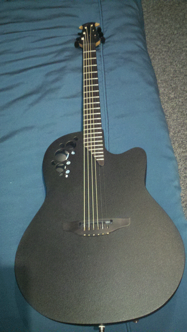

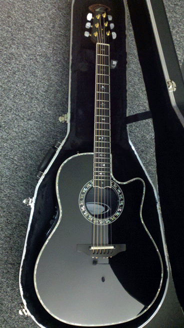

Couple of pics of new additions.
1778T
C20789LX

Very Nice!
One for the High-Brow folks and one for the Punk Rock crowd?

OMA: I was thinking more along the lines of owning one of each (shallow, mid-depth, and contour bowl).
