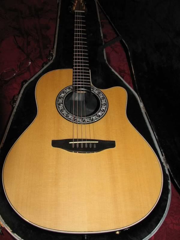

Hey folks,
Here's my situation....
I have a 1989 Custom Legend.
Outstanding tone.
There is a slight "bellying"
right below the bridge....
And the back end of the bridge
has a gap the width of a pick.
So, my action is on the high side.
It's playable...but I can't adjust
the action at all by removing shims.
If I did, the strings would lay on the
bridge & intonation would be a nightmare.
Any suggestions on exactly what repair
needs to be done?
And the approx. cost.
I've tried contacting the "mothership"...
No reply.
I am the 2nd owner of the guitar.
I really want to get the action lower...
Because the guitar sounds fantastic.
Any help?
Thanks!

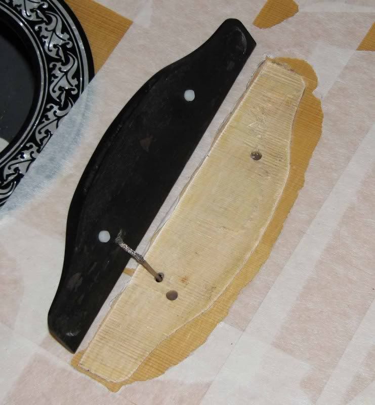

Hi everybody. I registered just to reply to this post. In the past few days I've read everything on the interweb about bridge lift on Ovations. Seems to be common and more frequent than on traditionally built guitars. This has to be because of the non-pin bridge design and the technique of gluing the bridge to the finish, not directly on to the wood.
I just got a 1997 Legend 5777-4es Limited Edition with a bridge lifting about 1/8" in the back. I called my local experienced luthier - doesn't work on Ovations!! I don't like the licensed Ovation dealer here - big corporate store, poor customer service, and very expensive.
So, having some repair experience on cheaper guitars, I decided to take the plunge and attempt a bridge removal and reglue myself.
Very nervously I probed under the bridge with an artist's pallette knife. Quite a bit of the bridge had come up. So I used an Exacto knife to score the finish all around the bridge. This turned out to be the most difficult step in the entire operation.
The finish is a very thick epoxy like material - very hard but very brittle. This is both good and bad. Bad because as you score it, it chips very easily so it is common to have some visible chips in the finish around the bridge after a reglue. Good because the finish does not penetrate the wood like glues or other finishes.
As a result(at least in my case) by working the palette knife under and around the edge, the bridge came off very cleanly bringing the finish with it. I flaked The finish off the bottom of the bridge with a knife which left a very clean
surface. A light sanding and I'm ready to reglue. For this I've made a clamping jig - 1 deep-throat clamp and an 2 aluminum bars with cork sheet glued on. I'll use yellow carpenter's glue and the bridge will now be glued directly to the wood. I've read that this can actually give the guitar a better sound - Can't vouch for that.
2 things I've taken from all this:
1)After seeing pics of the damage done to the top and finish when an Ovation bridge completely pops on its own, I would say the sooner you repair a lifted bridge the better.
2)If my experience is common, any luthier should be able to do the job.
P.S. Apparently, some Ovation bridges have bolts under the dot inlays. Mine doesn't but does have 2 plastic dowels underneath that fit into holes drilled in the top and the bridge. This was another pleasant surprise as they line the bridge up perfectly for the reglue.
If anyone is interested, email me through this site and I can describe the operation, tools, jigs, etc.. in more depth. Thanks, Steve.

Hi again. I did take some pics of the latter part of the operation. Let's see if I can make this work.

It has nothing to do with the bridge being attached to the finish, or the pinless design. It's down to glue seam failure, which can happen to any instrument at any seam, regardless of manufacturer. Ovation guitars are no more or less prone to this than any other shop-built guitar.

Respectfully, the glue or the 'glue seam' was not the problem here. The glue was holding as well as when it was first applied. It was the thick brittle finish that cleanly detached from the wood. That finish was still firmly attached to the underside of the bridge where it had pulled up.
