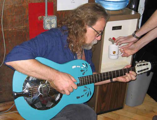

I've seen this one ...
... but I'm not sure if it's a Dobro or a Resonator or what. I always get confused about which is which ...

Very nice.
Do you know who built it?
Posted 2009-06-15 1:48 AM (#411879 - in reply to #411876)
Subject: Re: Ovation Dobro?
It was at the factory, so I imagine they did. It may have been a skunkworks project prototype that never saw the light of production. There's a few other folk around here who know the whole story. Hopefully they'll chime in.
I think a person or two around here also tried to do a resonator project on their own. I don't recall who they were or how they turned out. But that factory palm tree with the MOTS headstock was really cool.

Yes, it's possible cos it's already been done. Not sure I'd want to stand right in front of it as both Reso's and Ovations were Built to be loud

Also there are 2 completely different types of single cone resonators, the dobro type and National type, so the correct way to differeniate between them would be "Spider Cone" and "Biscuit Cone" which refers to their bridge arrangement. The Blue Ovation Reso has a biscuit cone

There's a very small number of the factory-built Ovation reso's around, and they sound great. They were all biscuit cones as far as I'm aware except for a very rare factory built spider cone owned by Al. You can hear a biscuit cone example here OFC jam

Here's one on the right side of this photo from Sept. 2006. It looks like one but I'm no eexpert. Will the owner please step forward and explain the specs.

Phil, I think that's the same one being played here by DesignZilla. It belongs to Beal:
