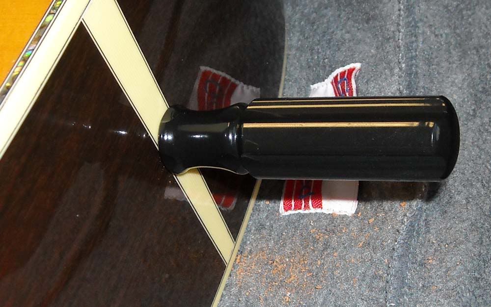

I pulled the end-pin and then took out one of the scariest looking tools on the planet. (It's a good thing Sharon Stone didn't find one of these in that movie.)
A little patience, a little grunt....a little more grunt...and the critter's driven home. Slight problem though; the shank wasn't long enough to ream an even hole through the end block.
It took a power drill and a LOT more patience to carefully widen the hole. But eventually, one of the test fits passed inspection.

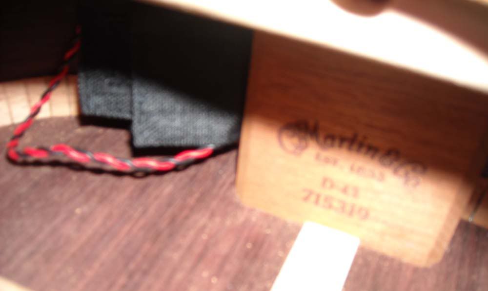

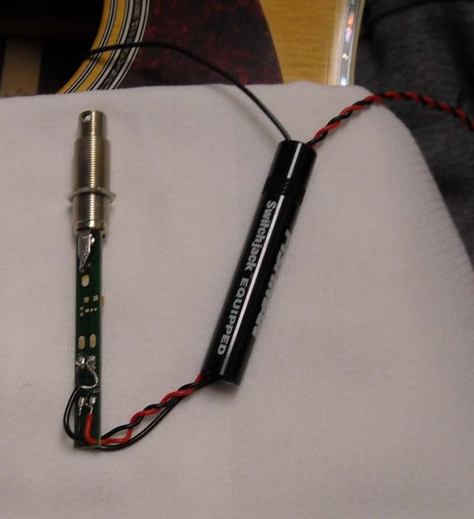

Solder the battery leads to the board, and screw the cover back on.
Put the handy, provided clips around the interior edge to take up the wire slack and place the sticky-backed velcro battery pouch next to the neck block.

I had the whole weekend to think it through before I had a chance to look at it. A little trial and error later, I swapped the wires I had soldered, and it works just fine.
