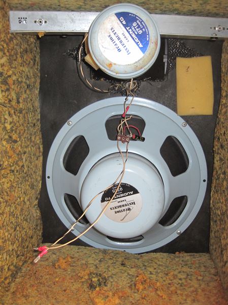

Sounds like the Reverb tank is missing. The circuit board is part of it but I don't recall Ovation using all electronic reverb. I don't think that was available then? There are a number of sites that have reverb tanks (E-Bay, etc) for not much in the $25 range? You could always borrow one from another amp if you have one just to try it. BTW, I had an Ovation K-6001 with a (4) 12" speaker cab with two horns. Getting a good distortion was tough but one trick I used was to jumper the two RCA's plugs together (bypassing the reverb tank) and it kicked it up the gain a notch. There use to be a Fender mod that had a little jumper module that did the same. Anyway, good luck.
Posted 2015-01-02 11:28 AM (#504380 - in reply to #376916)
Subject: Re: Ovation Speakers
I took the whole back off yesterday and discovered the reverb tank mounted to the top. Either the RCA plugs had fallen off or I pulled them off when I opened it up the first time. The wires were so short that they pulled out as soon as the back was opened a couple inches. I fixed the broken wire to the horn, took some pictures and closed it back up. The reverb tank has a female output jack on one side and an input jack on the other. I plugged the RCA plugs in, but the reverb didn't work. I couldn't tell which of the male plugs was the output and which was input, so I switched them and still nothing. The amp sounds pretty good, though. I'll try to post some pics this weekend.

I found that my reverb actually works but there is a problem with Channel 1 which just hums as if a ground or open somewhere. When I cranked up the treble control on Ch1 and tapped the reverb tank I can hear it come thru. So some progress made. Ch2 (using the Ch2 isolated speaker output) works fine but the Reverb doesn't. So somehow it maybe tied to the Ch1 problem or someone rewired it and without a schematic it will take time to chase this down. Next step is to swap Ch1 and Ch2 preamp cards to see if the problem moves with the card. Had the chassis completely apart last night to investigate the reverb channel switch board since that is also where the speaker outputs connect to. The missing component on the reverb card is not the issue since the circuit etch goes to a terminal on the card socket that is not connected to anything! Interesting comment on the "popping" sound when using the switch for your reverb. I have the same issue but only on the "Fuzz" switch.

You are into it way deeper than I am.  Fortunately, my amp is a bit simpler.  If you can figure out which RCA connector goes to each end of the reverb tank, that would give me a start.
K-6300 with reverb tank at top

Ok, my reverb tank is actually stamped "input" on the right as I'm looking at yours above, and "output" on the left. I didn't notice at first since the stamping was a little hard to see with the oxidation of the housing. Mine looks identical to yours and is horizontally mounted. Not sure who the manufacturer is since there are no distinguishing model numbers etc on it! But it looks like a common Accutronics from that era. I also noticed that one of the RCA cables has a shield but is NOT connected. Since the outer ring on both input and output jacks are riveted direct to the housing(no insulator), they are essentially grounded so only one cable shields needs to be tied to ground. I thought it was a mistake at first but I found some good documentation on reverb tanks that says certain models do this!
Posted 2015-01-05 5:20 PM (#504454 - in reply to #376916)
I could see the stamping on mine, too, but couldn't figure out which of the RCA plugs was for the input and which was for the output. I put all the screws back in the back panel. The foam is falling apart and makes a big mess, so I may wait to get some replacement foam before I take it apart again.

Ok another angle. The "output" RCA cable on mine does NOT have the shield landed on the connector for the reverb circuit card. Only the input cable had the shield landed. So that may be an easy way to distinguish which one is which. If all Ovation amps used the same reverb tank then hopefully the same grounding scheme as I mentioned earlier.
