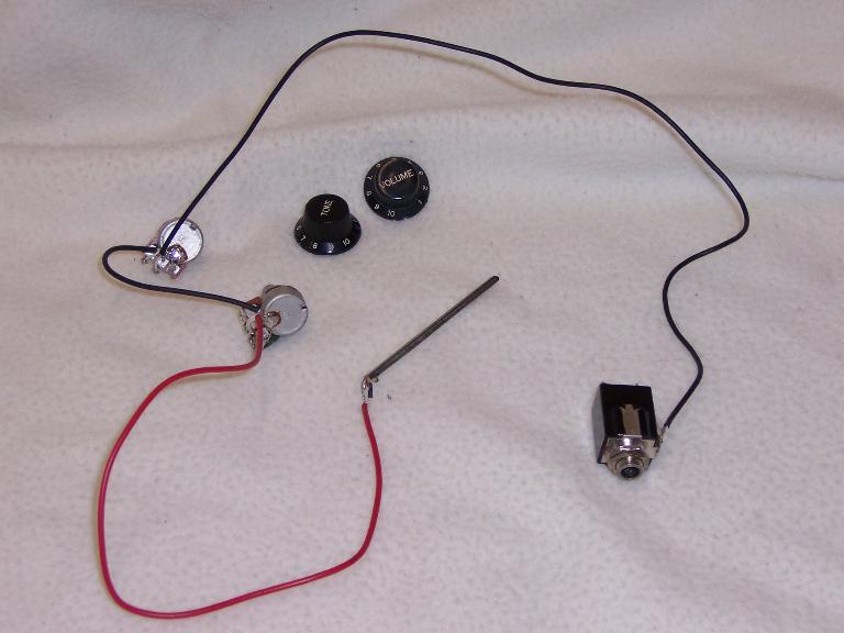

Some months back I gutted my "O".. okay, it's an "A". In preparation of bridge work. And umm... I lost the paper diagram I made which told me which pot was the volume and which was tone. And .... umm... which went in which hole.
HELP! Can anybody help me ID the Pots and proper location?
FWIW She's Otilda, an AE33
For reference sake, let's call them, in order:
Jack
Pot1
Pot2
pick-up

The Volume pot is first in line from the piezo and is placed closest to the neck.

You could just put the pickup in, plug it in and strum the guitar. Try the pots to see which one is the volume, and mark it. Put them wherever makes you happy.

Just plug it in & tap on the pick up . . .

You should be able to idenify the tone pot by the fact that it will (or should) have a capacitor soldered to it.

Thanks. I'll look for the cap.
