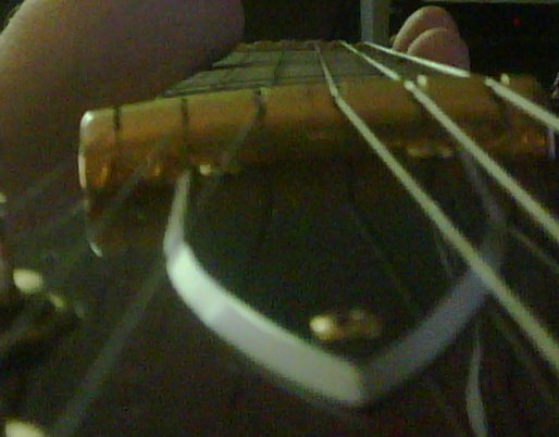

This is sighting down the neck on one of my intact UK IIs:
I've taken the neck off of the new basket case (someone else already broke the adhesive) and taken the tension off the truss rod and so far it's relaxed back pretty close to straight. The twist in it was about as bad as this one.
