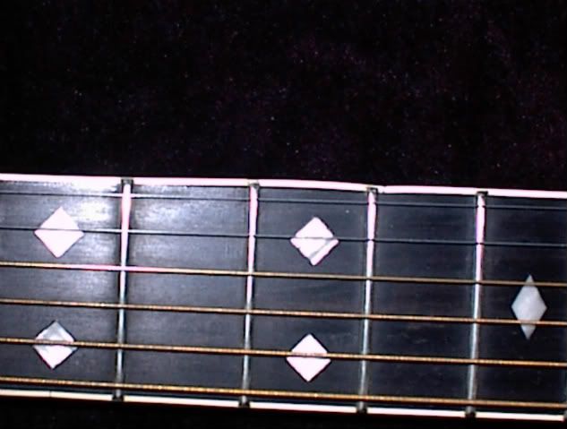

Same photo only bigger.
As you can see, the binding is coming off of my 'new' Legend.
The binding isn't totally falling off, but I imagine that I will have to pull it off to put it back on. :eek: :(

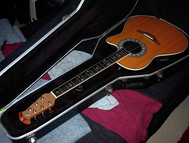

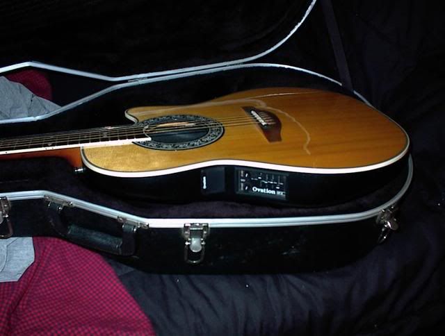

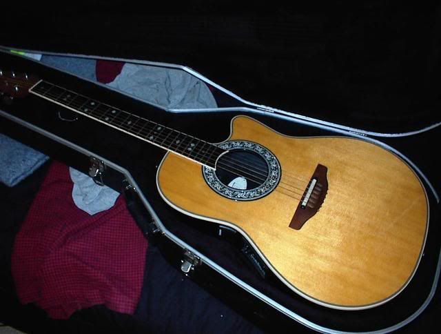

OH! I was so distracted that I forgot to just take some beauty shots of it! (hold on a moment...)
With a little bit of work, this will be a nice guitar. And my only SSB.
