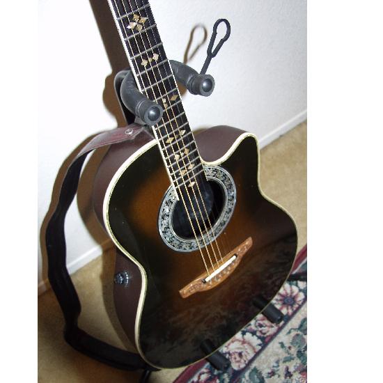

On my 1669, dark sunburst, I have asked others to find the cracks I removed...one crack which was deep on the bass of the centerhole is evident but reduced and not obvious from 2-3 feet from the guitar.

this is the 1669 that I worked on that I took before finishing up some minor issues:
from something fitting for a trip to the garbage can to a very nice guitar...and a boomer.
have used it as a slide guitar with a nut extender.
