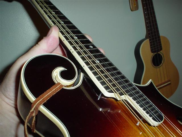

That looks like a fantastic job, I think I'll invest in a bottle for my soon to arrive Breadwinner - Any advice for avoiding the frets and position markers? (Just be careful I suppose??)
TRboy
Posted 2008-06-04 7:02 PM (#37538 - in reply to #37511)
Subject: Re: HELP! Fiebings Proffesional Oil Dye in UK!
February 2003
Posts: 2178
Thanks Capt!
You should have no problems with the position markers as long as they're abalone (wood markers while they may be sealed on the surface may still take on some black by the Fiebings "wicking" in from the fretboard)
Also I see no problem with frets or bindings (solid surfaces that don't absorb...except for tiny fine scratches may be highlighted) Just apply it sparingly with a small brush or rag....give it a sec or two to soak in then wipe the excess off right away......
I re-blacked the fretboard and "ebonized" the rosewood bridge on my Kentucky mandolin with no problems....
Good Luck....and post some pics when you're done!
Be extra careful with the Fiebings or you'll really be Captain BLACK ! :D
